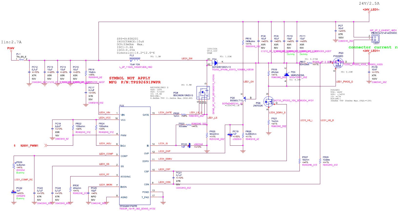

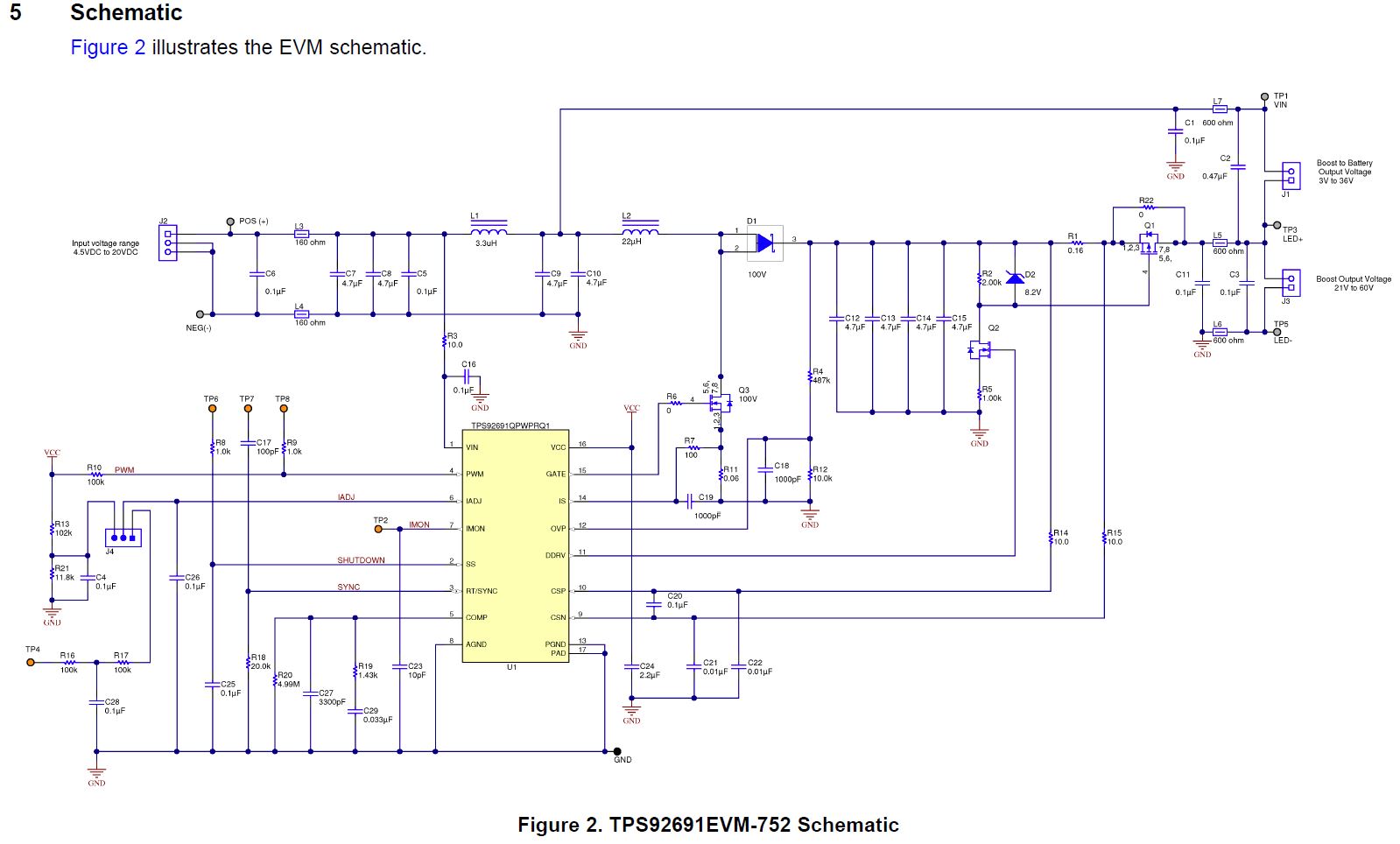

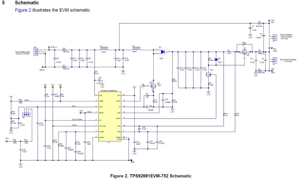

Our customer have design TPS92691 and they currently try using our EVM to modify to their application to earlier testing. and currently they got some question.
1. They have tried to modify the EVM into their design and it seems having some issue with LED light. Could you kinldy help us check if there is any part that we should be noticed? we have modify about the the part and relation connection to the their design expected PQ5 . please kinldy help us with it .thanks in advance

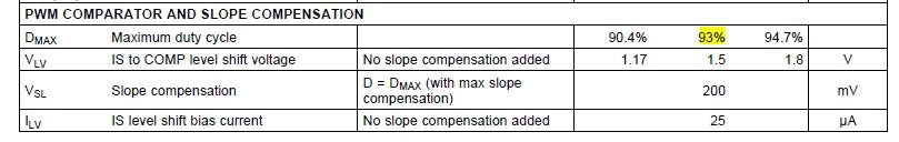

2. PWM max duty cycle
We notice that for the PWM max duty cycle is only 93%(94.7% max.). But can we be able to use TPS92691 for 24V to 24V 2.5A  LED driver under buck-boost application? Please kindly let us know

    Question 2 from above:  The specification you show is for the internal PWM comparator and slope compensation only.  You can drive 24V to 24V at 2.5A for buck boost configuration full 100% on.   This is high output power and for buck boost the power dissipation on the switching FET can be high so that what you will have to worry about.

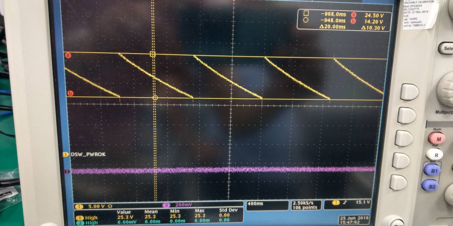

  • ()Dear Sir,
    Here are ore detail description about customer's issue.
    They Modify EVM to their their design(as i mention in my previous mail). With their 60W  LED module, the Vout looks a little un-normal shown as below(there is ramp wave on the Vout) . and the LED module is on and off as the ramp wave cycle. And then we lower the Vin to under 22.7V , then the LED module work fully turn on but the Vout still similar to the waveform below

  • Alec,
    Please have scope capture of what PWM input (pin4), current on the LED with a current probe, GATE ((pin15) and Vout.  One scope capture with all the signal on it.  The timebase should be such that we see 3 PWM pulses and triggering the scope off PWM.

    Now we could power up and light up the LED 60W module. However, for RD's design is 24V to 24V@2.5A . and currently. we only measure 23.3V Vout. we have tried to adjust the OV to higher set point but it seems no help for the Vout(we have used the same LED module on RD's another design with  TPS92602 . and the Vout can be upto 26V output when we adjust the OV pin setting of TPS92602). Could you kindly give us some suggestion about to improve the Vout to match their design(24V to 24V@2.5A) thanks in advacne
