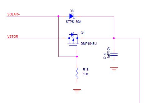

  • Hi Jeff,
    Thank you for your reply and valuable valuable.
     In my circuit VSTOR is connected to my load circuit.
    i)As per below circuit we have designed like when solar is present battery wont connect to the load.
    ii)When solar is not there battery will connect to he load.
    Can't we connect VBAT_SEC directly to my load circuit instead of Vstor. My circuit needs battery all the time. Will it charge if i connect VBAT_SEC?
    In the morning my circuit is working fine. In the evening my circuit is not getting the power. I am not getting where i am doing the mistake?
    I want to turn on internal fet between VBAT_SEC and VSTOR permanently. Will it be okay? Will it charge my battery ?
    Please help me out. Waiting for your valuable response.
    Ram.
  • Dear Jeff,
    I am requesting you to respond on this at the earliest.
    Ram.
  • Ram,
    I do not understand the circuit above.  Is the solar panel output going directly to the system load or battery, in addition to the input of the charger?
    You can connect your load directly to the battery at BAT_SEC.  In either configuration, the load and battery are parallel loads from VSTOR.  The system load is lower resistance so it will pull the most current, with the remainder (if any) going to charge the battery.
    Jeff
  • Jeff,
    Thank you for your valuable response.
    Actually what happened we have connected load circuit at VSTOR.
    when VIN_DC applied by solar panel the VBAT_SEC and VSTOR is connecting and after some time internal FET is getting turned OFF. So at VSTOR i am getting zero volts.
    So i have shorted both VSTOR and VBAT_SEC on my PCB to give continuous power to my load circuit.
    Is is okay?
    Ram.
  • Ram,
    Yes.  The internal PFET between VBAT_SEC and VSTOR only turns off when V(VSTOR)<2.2V.  Is your load too much for solar panel and therefore causing your battery to get depleted?
    Jeff

  • Jeff,
    Can I connect VBAT_SEC to System Load Without connecting to VSTOR(no connection Between VSTOR and  System Load).
    Ram
  • Ram,
    Yes.   However, the benefit to connecting system load to VSTOR is the PFET preventing the battery from going below the undervoltage threshold (2.2V).  However, if you are certain that your input power availability is enough to power the system and charge the battery, this will not be an issue.
    Jeff

  • Hi Jeff,
    Find   My Final  Circuit Below  and  whenever required Power to load it supplies and also  Battery is charging. Give me yours valuable suggestions if any.
    Ram
    My_Testing Circuit_BQ25505.pdf
  • Jeff,
    Please Reply ,on the Above Query,
    Ram
  • Ram,
    Again, the charger will function but, by shorting the charger's undervoltage prevention PFET, you run the risk of over-discharging your battery unless it has an internal protector to prevent overdischarge.
    Jeff
