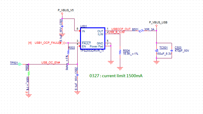

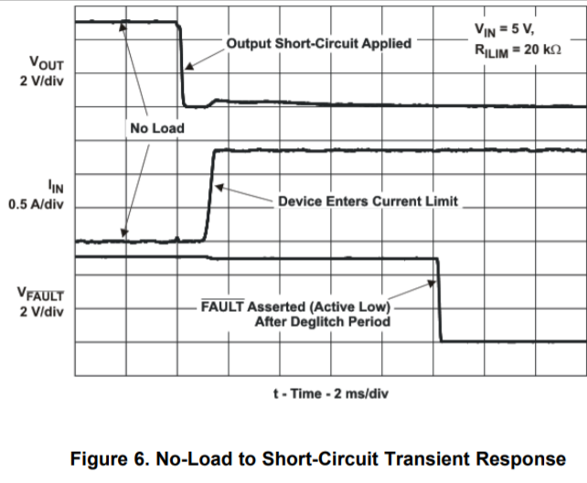

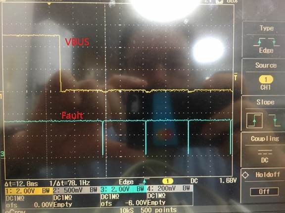

When TPS2553 output short to ground, I don't understand why the actual waveform at FAULT pin doesn't match to our datasheet?
I thought FAULT should stay LOW forever until output short remove, am I right? But as you can see the picture below, it only stay LOW for 100uS and pull HIGH. Something wrong with the schematics? Thanks for checking.
