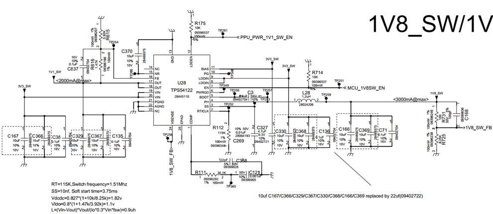

just want to check on below questions:
we found SW waveform as below at light load, does it means the HS FET body diode works but why does it works?
Given,
The TPS54122-Q1 is sinking current when the low side switch turns off. During the dead time it will flow back to the input thru the high side body diode which clamps the SW node to one diode drop above VIN.
Given,
I have not seen that before. Perhaps your output is being pre-baised. Can you post with EN, SS and the SW node?
