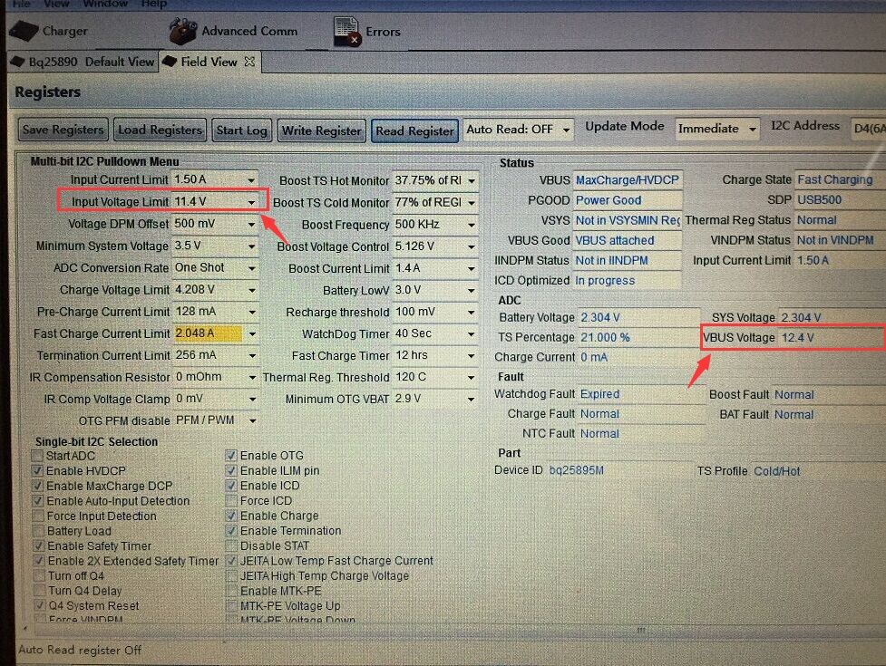

                    Thank you for your reply.

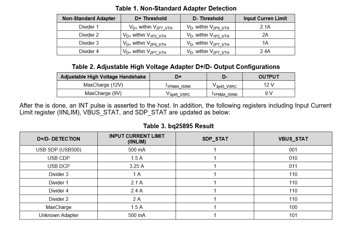

                    I know that bq25895 only supports QC2.0 but not QC3.0. I want to know which register bq25895 is modified to get 9V instead of 12V. The specifications of BQ25895 are not reflected.
    Simple D+/D- voltage control
     Negotiation scheme: Charger indicates adapter to increase VBUS using D+/D-
    pin voltage control. Controls VBUS between 5V, 9V, and 12V.
     Host control: Two bits to control the interface in the BQ2589x family:
     EN_HVDCP: 0 – Disable, 1 – Enable interface
     EN_12V: 0 – VBUS=9V, 1 – VBUS=12V
    I can find EN_HVDCP, but I can't find EN_12V

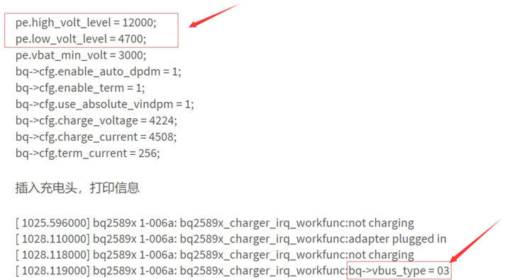

    Can you provide driver code for bq25895?
    EN_12V is not needed. If HVDCP is enabled, the input voltage will go to 12V automatically.
    Sample driver code is located at .
