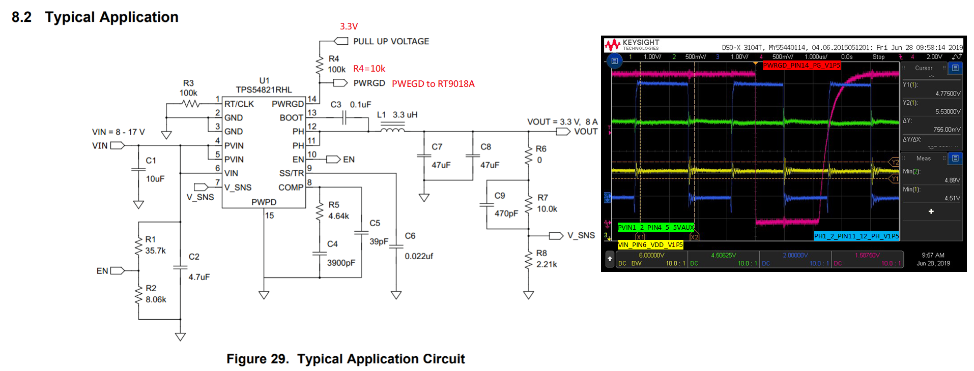

TPS54821: TPS54821 PWRGD turn low issue
Part Number: TPS54821
Hi Sir,
Our customer have PWRGD turn low issue, we are check the schematic PWRGD pull high R is used the 10k,
If we are change to EVM suggest 100k, then Solve this problem.
what change the  PWRGD pull high R improve this issue?
what's the  PWRGD pull high R minimum value?
CH1=VIN
CH2=PVIN
CH3=PH
CH4=PWRGD
