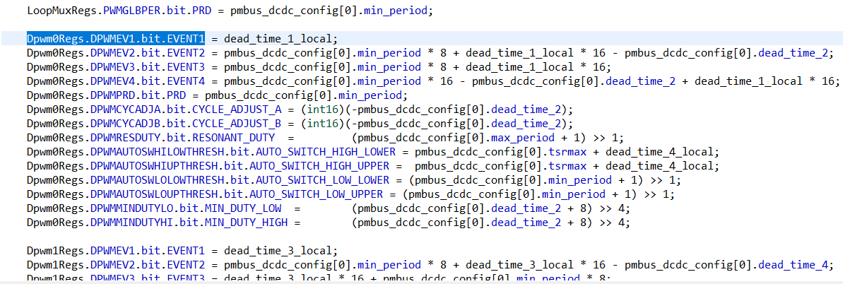

CCS/UCD3138: UCD3138 Automatic Mode Switching
Part Number: UCD3138
In UCD3138 Automatic Mode Switching, How to make the DPWM work on PCM mode when the Filter Duty trigger goes above the High Upper threshold and the DPWM output small Duty when the Filter Duty trigger goes below the Low Lower threshold.
