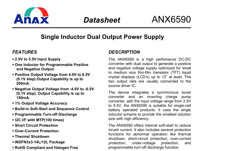

Do we have similar parts to ANX6589? The input voltage is smaller than output voltage so need boost inside. Output voltage are +6V/-6V for hardware setting. Thank you.

The closest device we have is TPS65132. Datasheet is available on TI.com

Customer concern their panel voltage is +/- 6V that is max output voltage of TPS65132 . They are afraid safe margin issue .
ANX6589 output range is 4V ~ 6.3V that is more margin for customer application Has any side effect to customer margin concern? Thank you.

TPS65132 should be able to provide 6V as that is its specification and if customer specification is also 6V, I do not think there is cause for concern.
