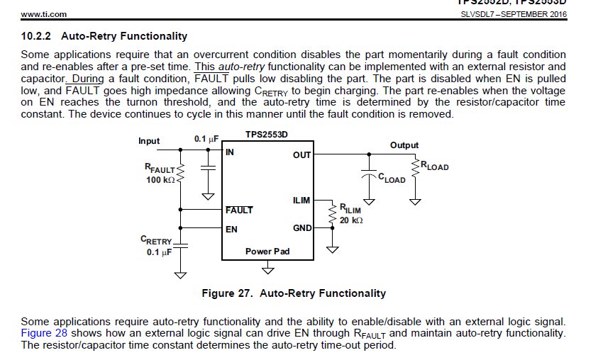

3: for the auto-retry function, please share the R/C time equation between Fault and En pin.
  • Hi Gordon,
    1. Yes, Fault asserts.
    2. As reach current limit threshold, Fault will assert with 8ms deglitch.
               E is Vin. caculate t as Vc(t) arrives Enable threshold 1.1V.

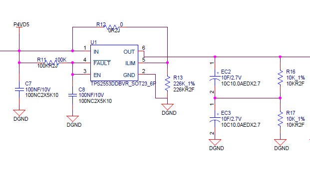

  • If I use the auto-retry function circuit and set the current limit is 75mA and my load is a super-cap.
    And then the Fault function always disable the chip and cuper-cap always don't charge.
    So, I can't use the circuit for charging function???
    Does it make sense??
  • R13=226K don't pop.
  • the over current condition  of The Fault function is not only for short circuit??
  • Hi Gordon,
    1. For current limit of 75mA, please refer to the following table on page 20 of datasheet:
    2.  The fault will assert as current limit not only for short circuit.
    3. With auto re-retry function, still can charge the super-cap. We call the current average current although has a period off time.
       I know your concern. For details, you can refer to the following information on page 22 of datasheet.
