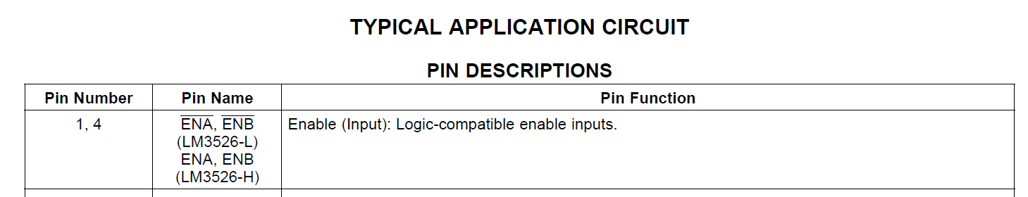

2. Is EN pin must be high for enable if answer is yes, can i connect that directly VBUS?

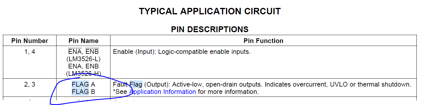

3. Is flag pin high or low in normal situation, can i connect that a led?
Best regards.

    2.
         For enable, refer to the above table on page 4 of datasheet.
        I am not sure what's your Vbus. For the threshold and ABS of EN, please refer to the datahseet EC table.
    3. For Fault:
    The normal operation is high.
