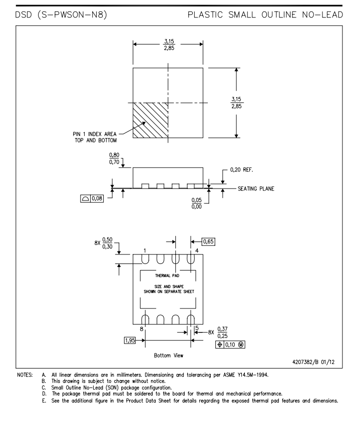

My Customer is looking for a recommended footprint for UCC27524 WSON (8) package. I tried to search for it unfortunately, the datasheet doesn't have this information.

Hi Renan,
Thanks for your help promoting our drivers, my name is Mamadou Diallo from the High Power Drivers.
The UCC27524DSDR is the recommended footprint for WSON package for this device. You can find the symbol and footprint on the webench cad page (link below):

Hi Mamadou,
Thank you for your reply.
It seems that the result shows the UCC27524_DSD_8.bxl right?
Do we have a pdf file like the one on the datasheet page 38 (D0008A Mechanical Drawing) for SOIC?

Hi Renan,
You're correct that is the result of the search.
If you're looking for the package drawing guide, below is a file that might address your inquiry.
