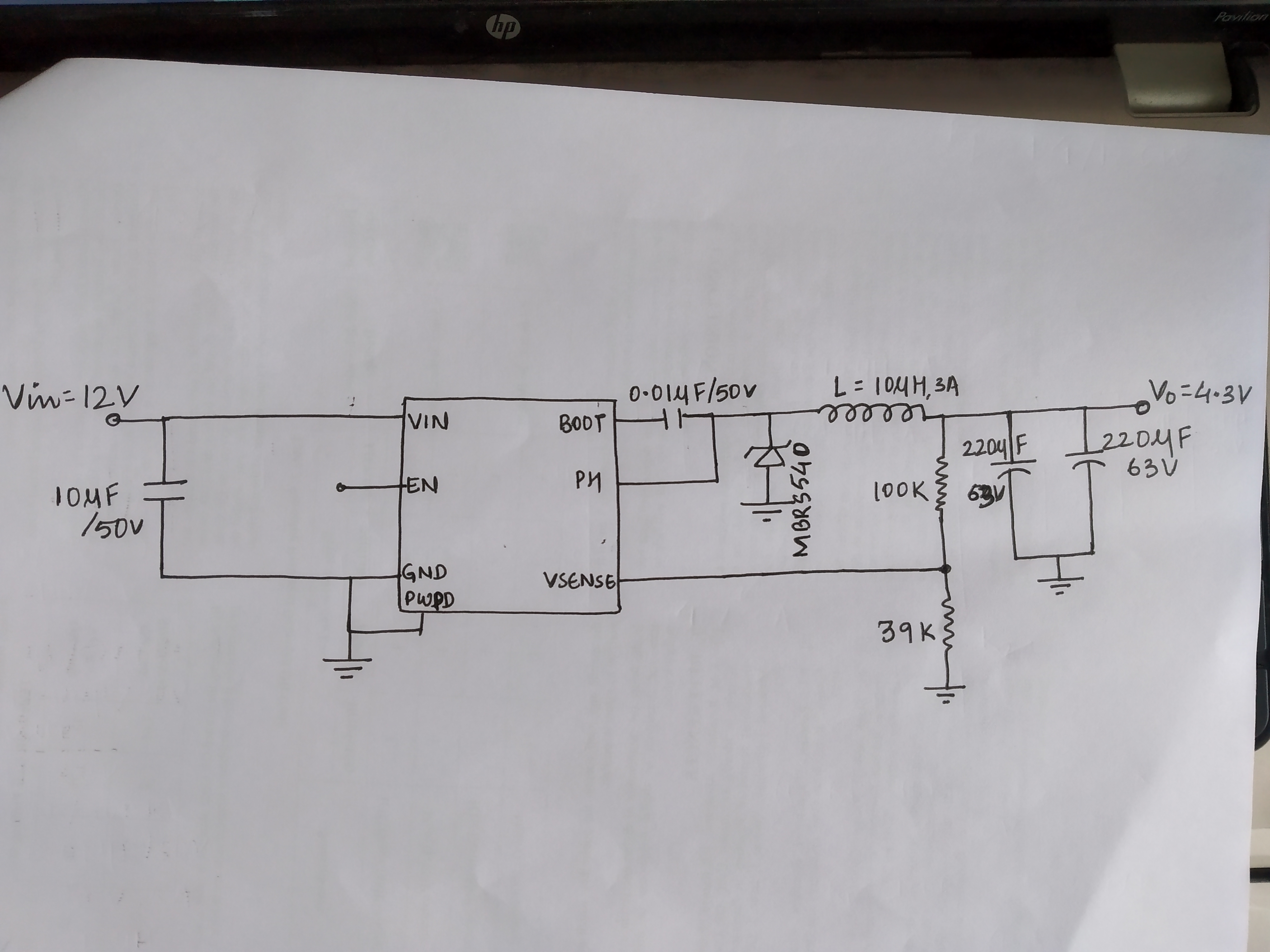

Iam using TPS5450,According to circuit diagram from datasheet there are resistor divider network of r1=10 k and r2=3.16 k, but in my case i use r2 =3.3 k as 3.16 k is not available. following are the observation
vin vout vsense(pin no 4)
5.5 3.6 0.98
6 4.08 1.10
7 5.02 1.36
12 2.92 0.80
when i apply input voltage 12 v or after 11v output voltage is decreasing, and after 12 v it remain contant 2.92 V.
and my requirement is vin =24v, vout= 4.2v and current =3.5A.
Please guide me how to achieve that.

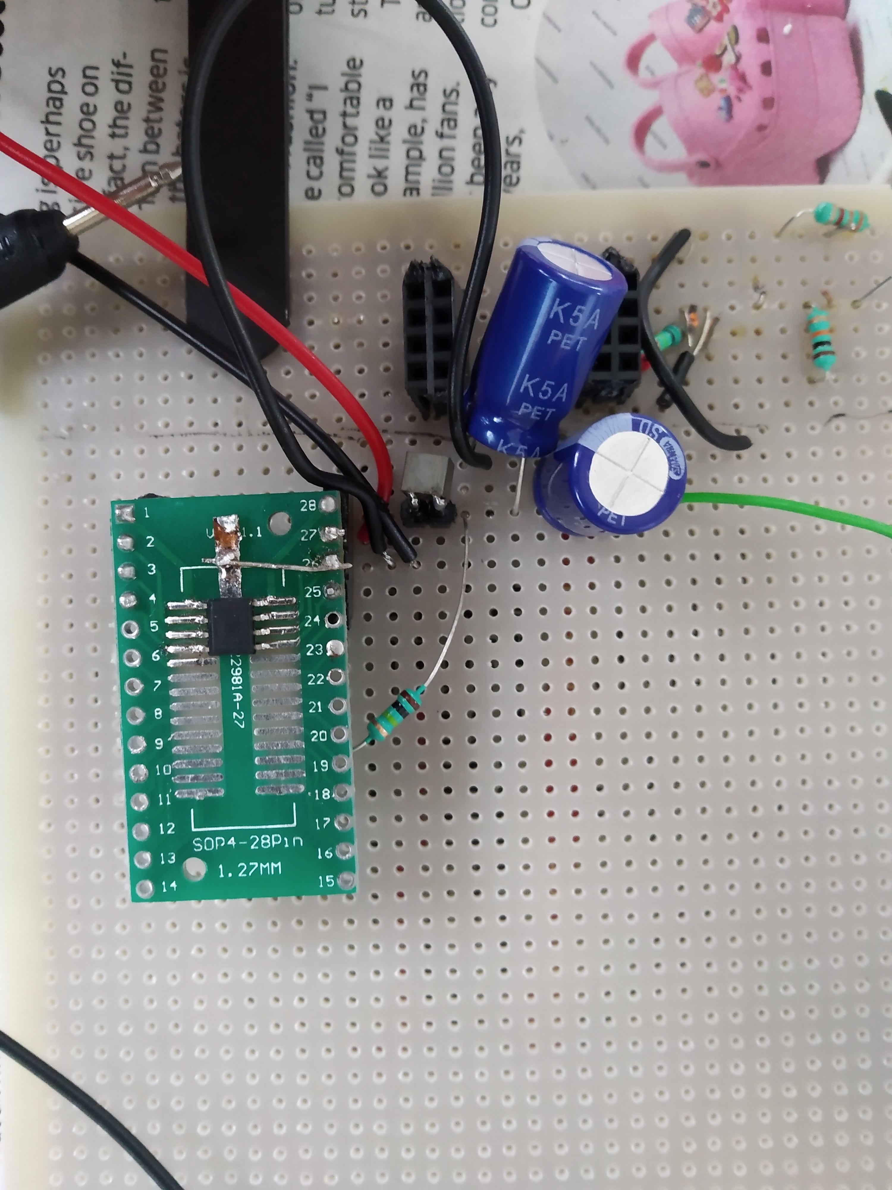

    Thanks for your reply.
    Please find attach images of circuit board which we have made. We have given input 12v and we are getting output 4.3 v without any load provided.
    Following are the observation we observe:
    1. When we increase input voltage gradually from power supply start with 5.5v till 6v, output is constant. when input reaches 6v, power supply getting short and we cant increase input voltage.
    2. When we give direct 12 v input without connecting any load at that time circuit works fine , when we connect load again power supply get short and drop down to 5.2 v.
    Kindly help.
  • Hi Ajitem,
    I'm not sure where the feedback resistors are positioned in your breadboard, but they should be adjacent the VSENSE pin (such that the VSENSE trace is as short as possible). It would be much better to use the TPS5450 EVM to check operation of this circuit.
    Also, the ESR of these output caps (220uF/63V) is probably excessive, causing a low-frequency ESR zero. I recommend installing ceramic output capacitors (e.g. 47uF/10V) that have inherently low ESR or a low-voltage electrolytic cap with reasonable ESR value (< 20mOhm). See section 8.2.2.6 of the TPS5450 datasheet for more detail.
    Tim
