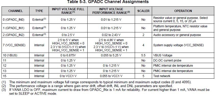

    I'm quite shure that GPADC_IN2 has a 0...2.5V input range with a divider of 2. Please see Table 5-3 (below) or chapter 4.3.
    I use GPADC_IN2 for hardware version identification. (please see picture below). The voltage is measured with a probe.
    When I go through all those values for R393 I can see that there must be an input impedance of around 33kOhm at the GPADC_IN2 pin.
    Patrick
  • Hi Patrick,
    You are correct GPADC_IN2 can have a maximum input of 2.5V since it has a scaler of two, sorry for the earlier confusion. As for the input impedance you are seeing, after looking through device documentation there is no specific call out for the internal impedance of the GPADC_IN2 pin so if you are seeing 33k consistently for your tests then using that value should be ok.
