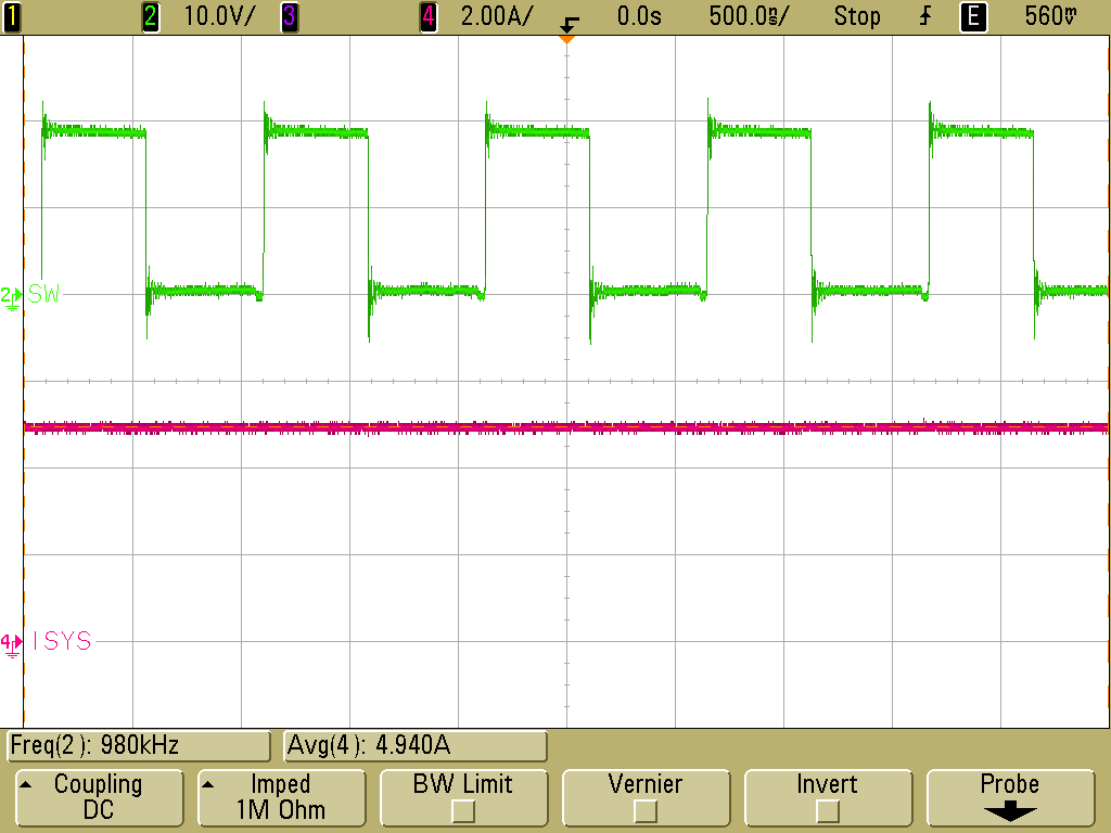

    I tried this on an EVM and don't have any issues pulling 5 A from SYS with a 1 MHz switching frequency, as shown in the waveform below. My adapter voltage is 20 V, and I have the EVM configured for 2-cell charging. I did not have a battery connected, and I was using an e-load in constant current mode to pull current from SYS.
    Can you describe your test setup? Do you only have the adapter and the e-load connected? What is your adapter's voltage and current capability, and can you send me your register values so I can try to duplicate your setup as closely as possible?

    Test Setup,1 plug in adapter(19V/3.5A) in M/B.2.Test Vsys voltage is 8.8V.   3. Load 5A use electric loading.  4.the Vsys drop to 2V. 5.test the ACDRV Pin the voltage will drop to zero then clamp up to 25V. 6    close the electrc load, vsys voltage come back to 8.8v again. by the way, tune the loading, charge can only support 1.5A loading. any other bigger than this value,vsys will drop to 2V.
    Regesister only set
    0X12=665E other regesister as default value.
    after write 0X12 to E144,the vsys will OK can load 5A.
    I tried to follow your test procedure, but was unable to duplicate the issue. I still have no problem pulling >1.5 A from SYS with a 1 MHz switching frequency.
    Can you capture some waveforms to show PHASE, VSYS, and ISYS for both 800 kHz and 1 MHz switching frequencies? Also, do you have a BQ24715 EVM that you can test this with?
