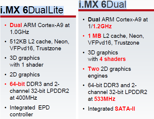

We have a question about TPS65911.
We find the reference design for i.MX6 by using TPS65911.
https://www.ti.com/tool/TIDA-00621?keyMatch=i%20MX6DL&tisearch=Search-EN-Everything
Can we use TPS65911 for i.MX6DL?
Please tell the difference between i.MX6 and i.MX6DL if we can use this IC and reference disign.

  • Hi Takahiro,
      The TPS65911 reference design you pointed is applied for i.MX6Dual, I think i.MX6DL is a shorted name of i.MX6DualLite; attached screenshot from Freescale's portfolio Overview shows the difference between them and surely i.MX6DualLite is a lite version of i.MX6Dual, so, you can use this PMIC and reference design.
