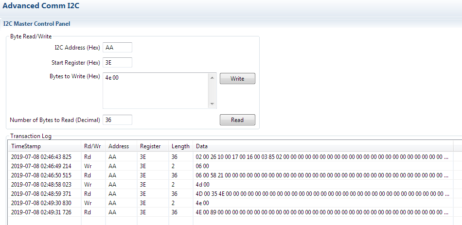

From below I2C read back using the BQ Studio, I would like to check with you what is the proper command and how can we read and convert the values for Manufacturer Date, Serial Number and Safety Status? I can't find any information on this from Technical Reference. Need your help.

    We are following the Little Endian Format as stated in the Technical Reference SLUUA65C. We had in fact successfully read the Voltage() by simply issuing 0x08. However we have issues with the registers in the AltManufacturerAccess(). We would like to know what is the command sequence in attempting to read the AltManufacturerAccess().

  • Hi Kat,
    This is discussed in section 12.2 of the TRM. For altmfg access, you simply communicate at 0x3e and send the command in little endian.

    We were able to read the chem ID using those steps. However, we are not only reading the chem ID. We also need to read other details from the AltManufacturerAccess() such as : Manufacturer Date, Serial Number and Safety Status. For instance, we had to 0x3E followed by the data in little Endian for the Manufacturer Date (0x004D), We then read 36 bytes from 0x3E.
    The question is, how do we determine the Manufacturer Date bytes and how do we convert them. The SLUUA65C has a very vague and unclear explanation.
  • Hi Kathleen,
    The procedure is the same. The only thing about the command is that it returns the command sent as the first 2 bytes of the data followed by the data in little endian.

    How do we convert the Manufacturer Date reading of 0x4E35 to MM/DD/YYYY format?
  • 0x4e35 in decimal is 20021
    1. divide by 512 to get year = 39, add to 1980 to get year, 2019
    2. divide remainder of 1 by 32 to get month 1
    3. remainder is 21 which is date
    so the date is 21/1/2019
