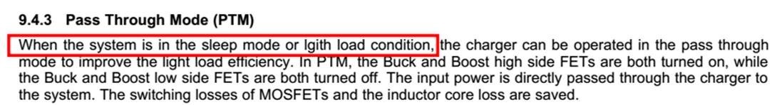

    About Pass Through Mode, is PTM operate only light load condition?
    Can bq25710 use PTM on High power condition? (For example, 50W, etc)
    Datasheet is described below;
    Satoshi
  • Hey Satoshi-san,
    The high power condition should be fine. Again, make note of the power loss elements in PTM, which are the input sense resistor (RAC), the two HSFETs, and the inductor. All of these devices will factor into the power loss seen at high current.

  • Hey Satoshi-san,
    1) Charge has to be disabled for PTM mode to operate. So yes, charging is disabled.
    3) PTM enabled is controlled by the ILIM_HIZ pin being pulled low. In order to be changed back to NVDC, the ILIM_HIZ pin will need to be pulled back within an acceptable range (between 1.2-4.0V).
