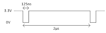

    The customer use case is Fsync=500kHz and a pulse width (pulled low) = 125ns.
    Does it work?

  • Hi Pol,
    I don't think this works with Figure 23.  If  you can get an inverted signal, go with Figure 24.
    The datasheet reads that "if the RC pin is held low for an excessive amount of time, erratic operation may occur."  Since the sync clock has much wider duty cycle, you should put an RC at the synchronization FET gate:  R is placed from the gate to gnd, and C is between the sync clock signal and the gate.  This will convert signal into small pulses.  The datasheet recommends: Typical values for the resistor and capacitor are 220 pF and 1 kΩ.
    Hope this clarifies.
