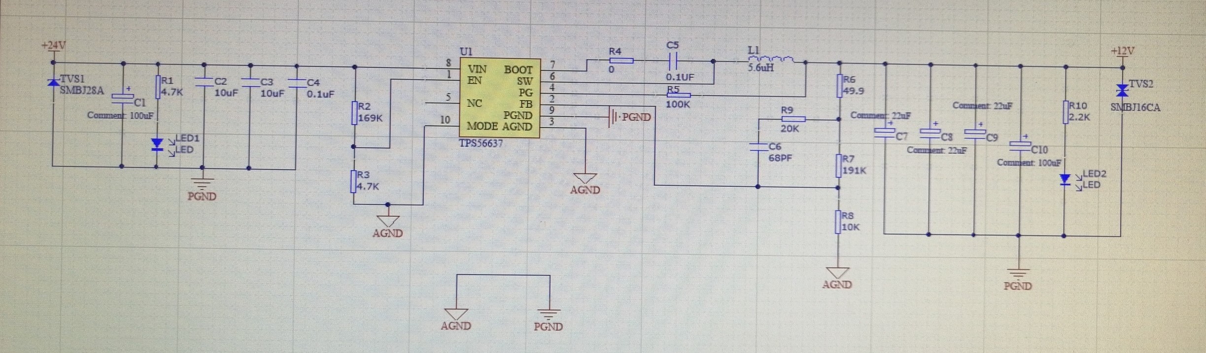

Hi team,
Could you please help review the below design for 24V->12V/4A.

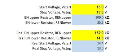

Hi Robin,
I have concerns on the EN resistor of R2=169k and R3=4.7k, which leads to a 45.3Vstart and 40.5Vstop. Please change it to R2=162k and R3=14.3k to get a 15Vstart and 13Vstop.
R6 is just for the measurement of loop gain, and it can be removed if no plan to measure it.
Also, please clarify the type or part number of output capacitors. Ceramic or electrolytic capacitor?
Thanks.
Bruce
Hi Bruce,
Now They don't have C1 C10 100uF Cap. They want to know if it is necessary for their design.
Thanks.
Robin
Hi Bruce,
No till now. As for the UVLO cal, for 15V/13V settings, I calculated the upper res is 373k and lower res is 31.9k.
Could you please help double confirm. Thanks.
