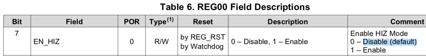

    With a good input source connected, HIZ mode will be disabled by default. The table below shows that at POR, HIZ mode is disabled.

    The above behavior is happen with a battery.
    We think that POR is not generated because there is a battery.
    Our test environment is shown as below.
    PC <---> EV2400 <---> PWR877 (BQ25601D Evaluation module) <---> Battery
    We tried the following tests. As a result, HIZ mode was disabled automatically in both tests.

    The behavior you're seeing in Test 1 and Test 2 is expected. After a good input source is plugged in, the device exits HIZ mode automatically. I confirmed this on an EVM and see the same results as you.
    However, I'm not sure why the overwrite you're describing is a concern. The IINDPM register setting should not be overwritten when the MCU reads and/or writes to the EN_HIZ bit. Have you experienced this issue on your EVM?
