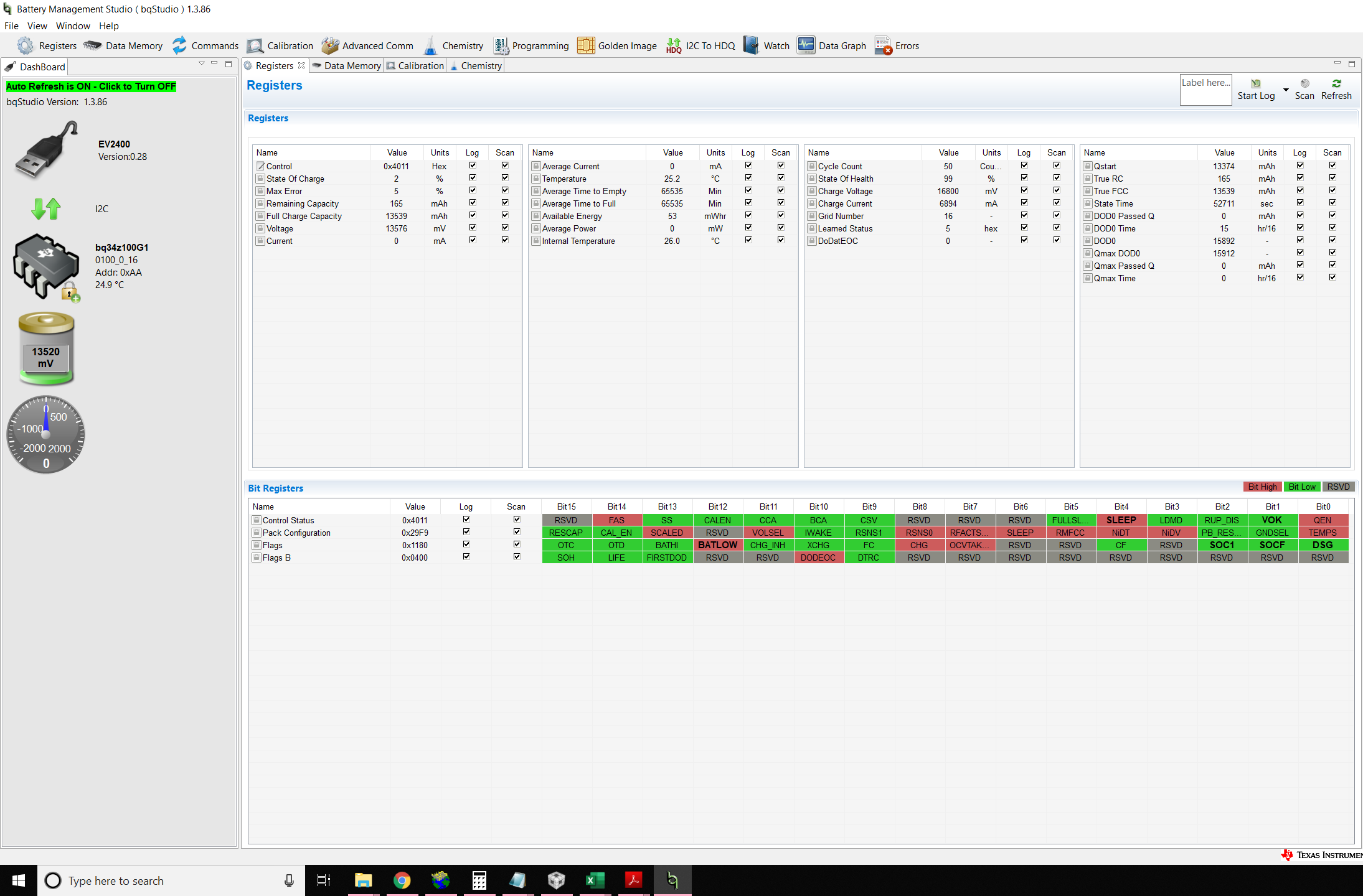

  • Hi Batt,
    I did as you suggested, and the Ra did update during the discharge with RUP_DIS set to 0 and VOK set to 1 during the discharge as expected.
    However, once the pack reached the cell terminate voltage (3000 mV) and the load disconnected, even after several hours of relaxation (> 12 hours), the Update Status did not change to 6 and the QMax was not updated.  VOK was cleared as expected, so I do not know why the QMax was not updated.
    I have attached the register screen seen during the relaxation period after discharge.
    Julian
  • It's your configuration that is causing an issue. I see that you have NiDV and NiDT set in pack configuration. This is seen in the flags. Your system is a Li-ion battery system. So, please reset them and run the cycle. Ni batteries use a very different method for chg termination and gauging. Once you set yours to a Li-ion setting, you updates should happen at the correct time.

    However, I did run the discharge cycle again according to your last instructions (setting the learning status to 5 first), and by ensuring that the load was minimised during the relax period, the cycle completed correctly.  Before, I had a single low-power LED lit to indicate that the discharge load was disconnected (drawing about 3 mA), but it seems that this was enough to prevent a QMax update (the delta-V / delta-t was > 1uV/s).  Disconnecting the LED allowed the QMax update to take place.  I also disconnected the load at 200mV below the termination voltage rather than at the termination voltage (set at 3000mV), which may have helped.
    I suspect that this voltage change sensitivity may cause learning cycle failures for other customers, and it would be useful to emphasise the requirement that the load is absolutely minimised during the relaxation period after discharge, when battery voltage can easily change with time, even with very small loads.
