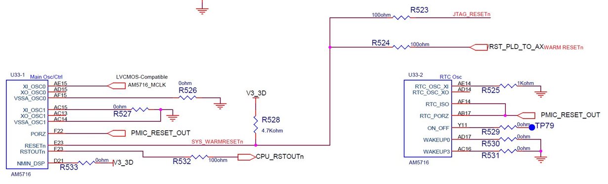

On my board I have a SItara AM5716 and its PMIC TPS659162RGZR.
Below I show the schematics about PMIC
and reset section of Sitara
AM5716_MCLK is a 20MHz clock and SYS_WARMRESETn is high.
For the connections I followed the Figure 2 of "TPS65916 User's Guide to Power AM571x (SLVUA04D)".
The PMIC RESET_OUT (net PMIC_RESET_OUT) and CPU RSTOUTn (net CPU_RSTOUTn) are always low (all the power supply of the PMIC are correct and the PMIC POWERGOOD is high)..
I put a 4.7Kohm to pull-up the PMIC_RESET_OUT and the behaviour of this net and CPU_RSTOUTn are the following:

  • Francesco,
    Can you scope VRTC, GPIO0, GPIO5, and RESET_OUT together?
    Also, can you see if the interrupt pin is going high?
    I would also recommend probing all the other GPIOs to understand if they are stable or toggling like RESET_OUT.

  • Hi Nastasha,
    I made some screenshots of the beaviour as in schematics I sent.
    As you can see the PMIC RESET_OUT is stable HIGH.
    INT is HIGH, too
    and powergood is OK:
    At this time I would expect going up the signal coming from SItara (GPIO1_NRESWARM) but is always LOW:
    If I put a 4.7K pull-up on GPIO1_NRESWARM I have the following effect:
    zoomed view:
    GPIO4 and GPIO2 are always stable HIGH, GPIO3 is always LOW.
    Do I make any mistakes?
    VIO_IN must be separated and delayed from VCCA or can be connected together?
    Thanks.
    Best Regards
    Francesco
  • Francisco,
    It looks like you are repeatedly toggling the warm reset (GPIO1). this is an active low signal. Every time NRESWARM is set low, the PMIC will perform a warm reset, which returns all the power rails to the default value and toggles RESET_OUT. If you are not intending to initiate a warm reset, keep this pin high.
    Nastasha
  • Nastasha,
    thank you for your support, it was very helpful.
    Finally I found that the SYSBOOT configuration of Sitara was not correct. This was the reason why the NRESWARM was always LOW.
    Now it works.
