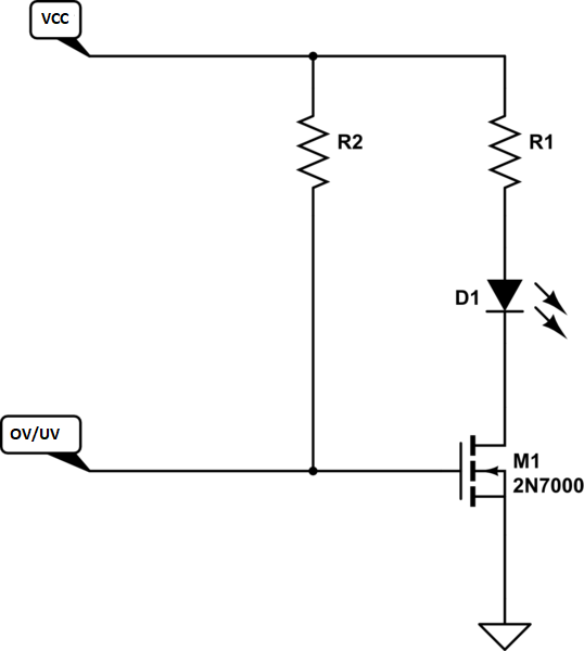

    How about adding some mosfet (like 2N7000 or 2N7002) to drive LED indicator from OV/UV output?
    Something like here :

    Are you suggesting me that using mosfet is not recommended or just not needed?
    Would you be so kindly to tell me what should I omit M1.
    I'm going to use that OV/UV signal to control startup of LDO's and DC-DC which are sinking very small currents after all.
    If this is important I'll try to use 2mA LEDs.
  • Mosfet is not needed. You can connect it to the diode pin itself. Max output current is 10 mA, which will be current through Rpb + LED current. Hence you can design your system accordingly.
