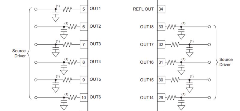

BUF20800: RC value
Part Number: BUF20800
Hi team,
Could you give a recommended RC value? Thanks.
  • Hi Miranda,
    RC output is not needed, for large system capacitive load an R is needed for output buffer stability.
    Recommended R for high capacitive load:
    10ohm for 0.1uF
    4ohm for 1uF
    1ohm for 10uF
    For C<0.1uF no R is needed.
