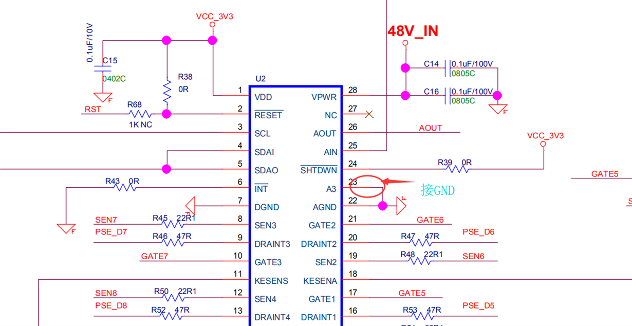

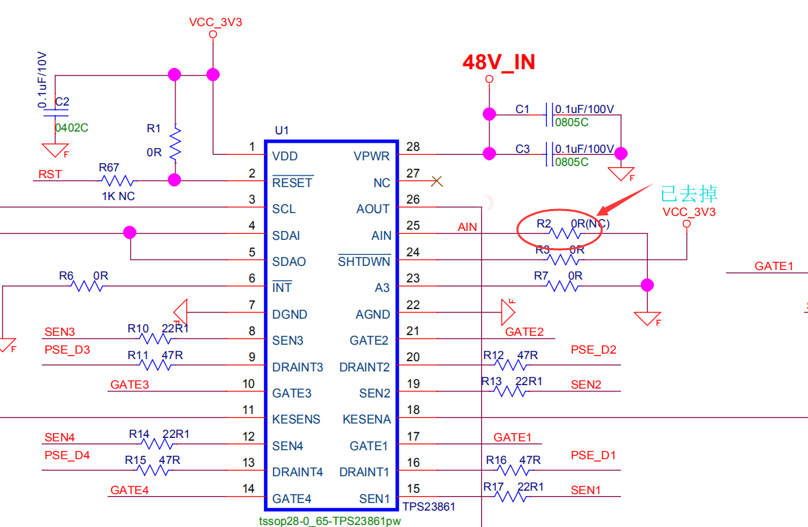

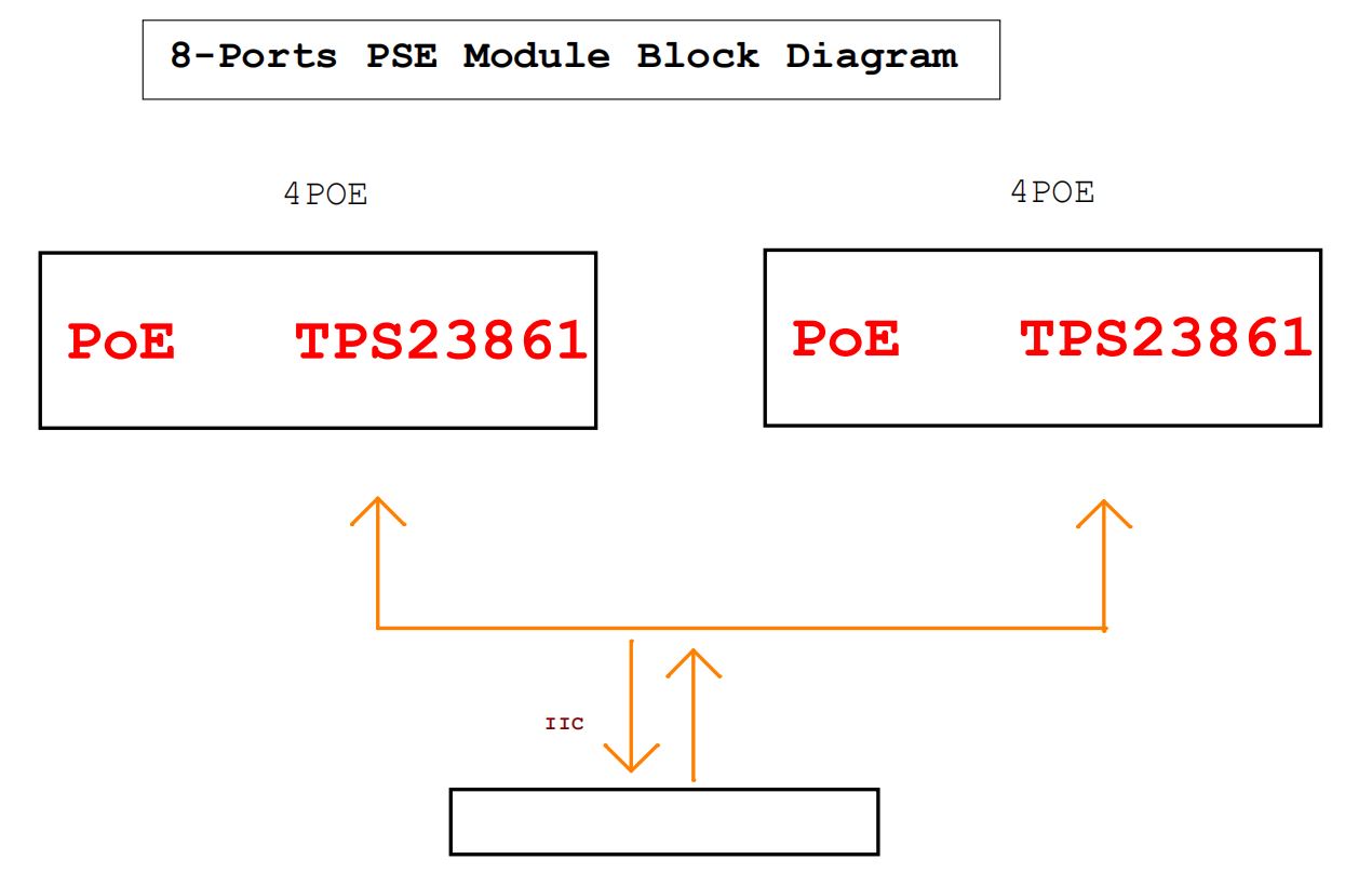

We have made an 8-port POE module with 2PCS TPS23861 chip.
We want to achieve two TPS23861 cascades by changing the circuit. The circuit has made the following changes:
1. The 25PIN of the first TPS 23861 is suspended. Because of its internal pull-up voltage, the AIN is high level.
2. The 23PIN of TPS 23861 is connected to GND.
By changing the circuit, software engineers can only read one piece of TPS 23861 through IIC at present.
Now I don't know if there is a problem with the circuit modification or if the software needs to be adjusted. Please give me some suggestions.

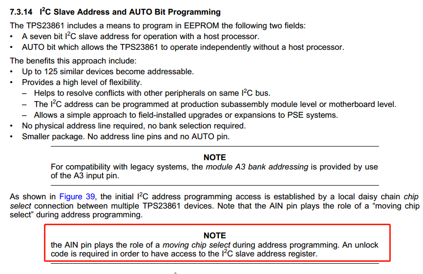

    Let's look at the development document 7.3.14 I2C Slave Address and AUTO Bit Programming.

  • Hi Jerry,
    I think your AIN, AOUT pin is correct. You connected first device's AOUT to second device's AIN and left first device's AIN and second device's AOUT floating. Can you double check the second device's (0x28) A3 pin status? Is it 3.3V or 0V? If it is connected to 3.3V, you have to program some address with bit 3 to be 1. If you want to program the address to 0x11, you have to make sure A3 pin is 0V. Thanks.
