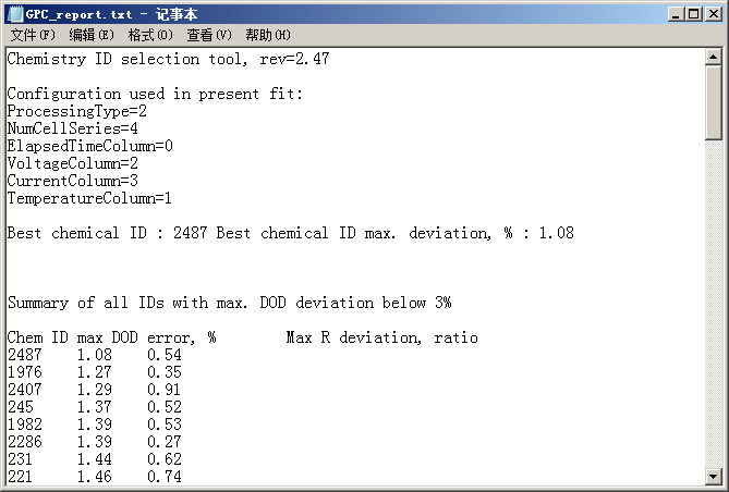

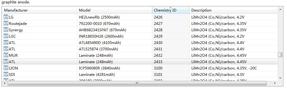

As the picture show, the best Chem ID is 2487, but I can not find it in bqstudio.
And how can I do for these issue?
Hi Skate,
Please update using the zip file from here, http://www.ti.com/tool/GASGAUGECHEM-SW. Open bqstudio and then click on help, update chemistry, select cancel and update from the downloaded file, I do see ID 2487 there.
