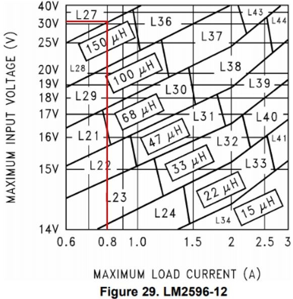

Our customer would like to know about contents of  LM2596's datasheet.
Could you answer the following questions?
The specifications of the customer's power supply are as follows.
Device: LM2596-12
Input voltage: DC20 to 32V
Output voltage: 12V
Output current: max 0.8A
The conditions for a maximum input of 32 V and a maximum current of 0.8 A can be written as shown below (Datasheet p.19 "Inductor selection" Figure 29).

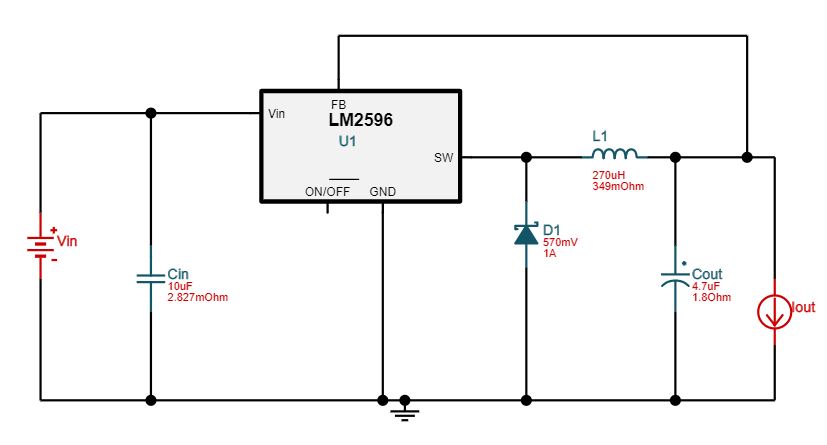

By the way, when I investigated using WEBENCH, the value of the inductor became a result of 270μH as follows.
There are differences with the data sheet values, but which one is correct?

  • Hi Y.Ottey,
    My recommendation is to follow the datasheet guidelines.
    Tim

    I have one more question.
    As shown in Figure 29 in the data sheet, in the case of customer's specification conditions, it is possible to select in the range of L27 for 20V and the range of L27 or L28 for 32V.
    If it is your specification, can you tell me which one to choose from?
    Y.Ottey
  • Y.Ottey,
    You can select either inductor if the selection is on a line between inductors. The performance will be slightly different for the two values but the part will still operate assuming the rest of the schematic/layout is adequate.
    I'd recommend using the lower value inductor. This will save cost and/or size in your system. You can move to the higher value if necessary after testing.
    -Sam
