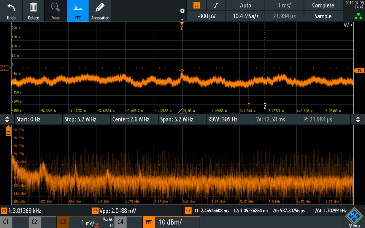

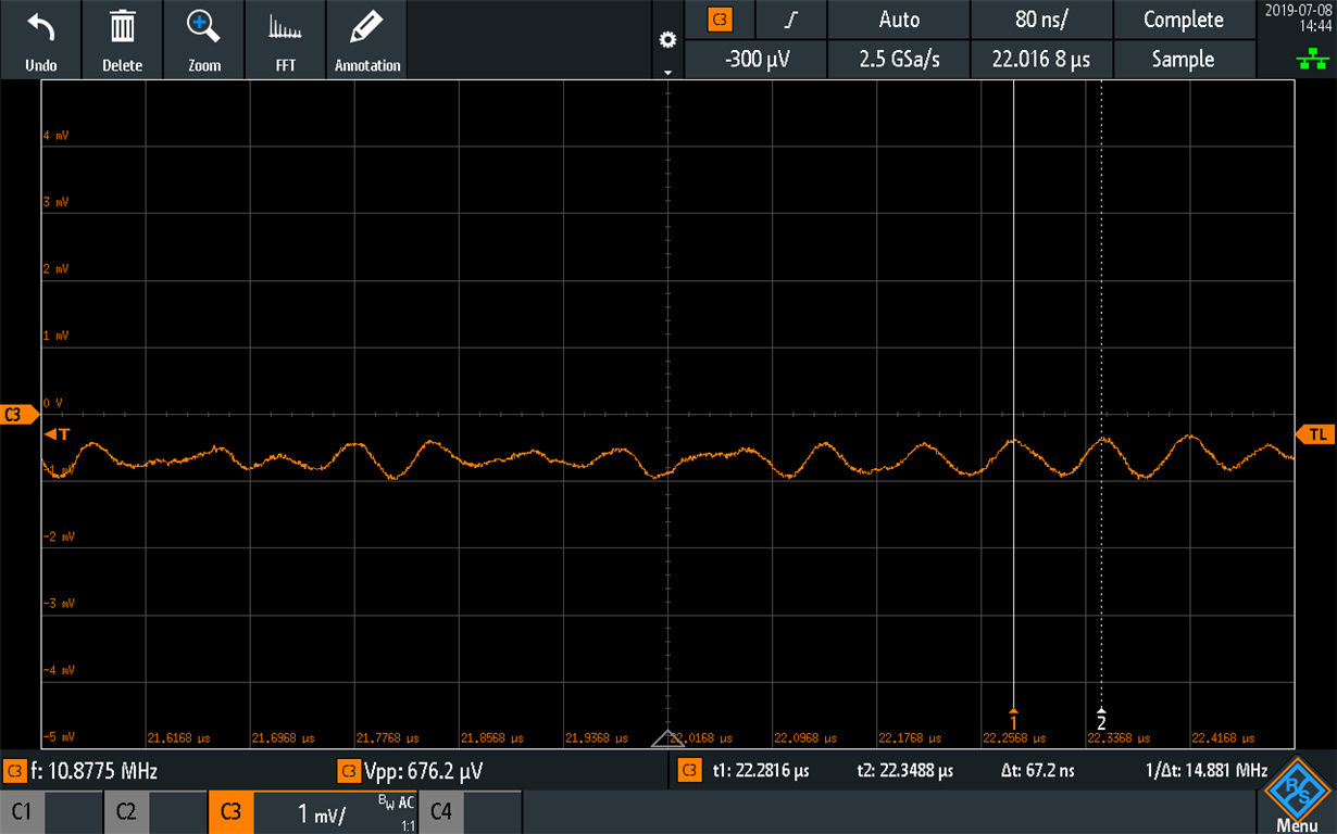

  • Output voltage is 1.8 V. We have the following ripple specification:
    10 kHz: 18.7 mVpp
    100 kHz: 2.6 mVpp
    1-10 MHz: <1 mVpp
    >100 MHz: < 3 mVpp
    These are only required for currents above 5 mA or so.
    For the TPS62740 EVK, and after increasing inductor size to 3.3 uH and adding a post LC filter (with damping) the HF ripple (~14 MHz) is below 1 mVp-p. There is some lower frequency ripple that may be of concern. We would like to investigate if it is possible to achieve low enough ripple without adding an LDO.
    Output voltage plots:
  • Thanks for explaining.  It sounds like your second filter allows you to meet your spec?
    Equation 3 in the TPS62175 D/S shows where the PFM frequency will be for a single pulse PFM system, like DCS-Control.  This can estimate where the fundamental frequency is for your conditions.
    In case you are interested, here is a technical article on designing these second stage filters: https://e2e.ti.com/blogs_/b/powerhouse/archive/2018/01/18/design-a-second-stage-filter-for-sensitive-applications
    Finally, for the TPS6274x, be sure and connect the Vout pin after the first inductor and not after the second filter.  This will give some load regulation across the second filter, but this should not be an issue with your low currents.
