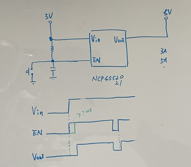

  • Hi Arthur,
    Our Customer is used the NCP45520 now, but if EN connect to VIN, then It's possible no Vout issue.
    So, they are want to use TI solution,
    If schematic as below, any risk on Vout ?
    Hugo
  • Hi Hugo,
    I don't see any issue using the device in the drawn configuration. What is your load capacitance?
