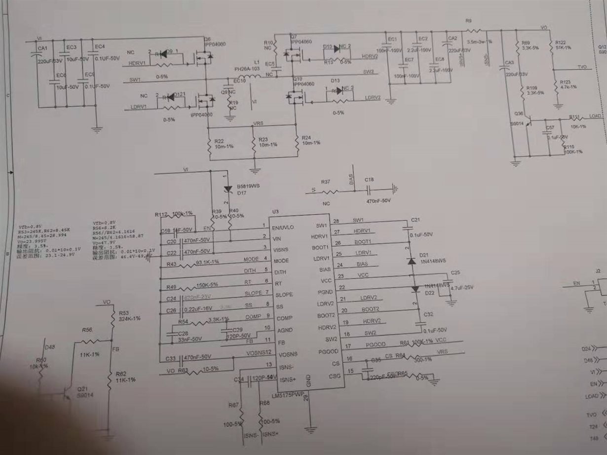

I use the LM5175 in my power degisn. Vin=12V~32V, Vout=24V. If the load in hot swap, the HDRV1 Pin will be damaged. The picture is SW1 (yellow) and SW2 (Blue) after HDRV1 Pin damage. Plaese help to deal with this question. Thanks~

Thank you for using the LM5175. Can you share your schematic? Also, can you monitor the input voltage at the SW1 during hotswap, so we can see if there is possible over voltage transient that may kill the high side driver?

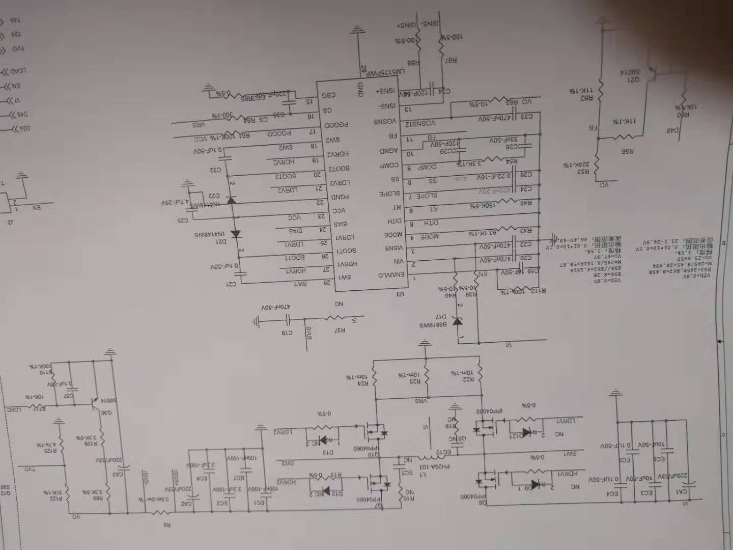

May I ask your to post the schematic NOT in upside down? I am not able to rotate it for a review, unless I have to turn my head downward.

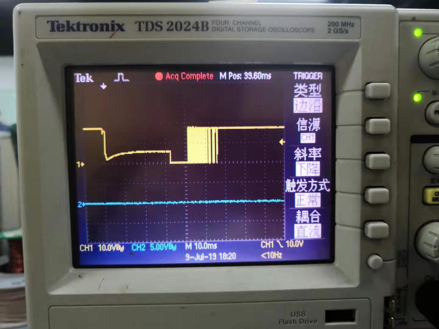

What do you mean by "the same thing happens when OCP"? Can you be more specific?

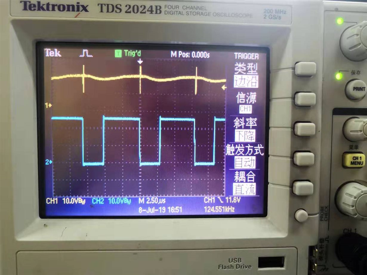

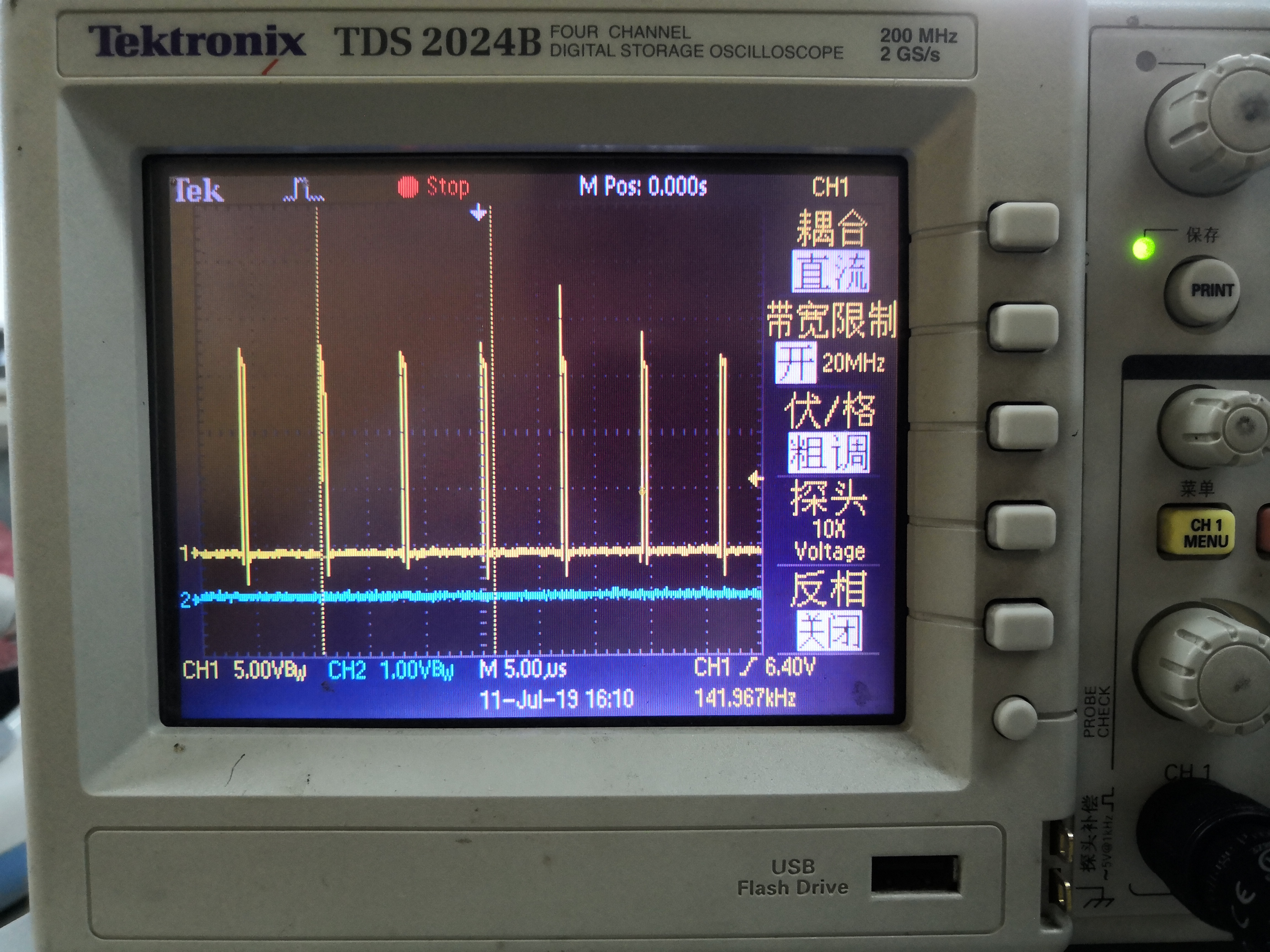

What is the waveform? Under what condition? I would like to see the SW1 and Drain voltage of Q6 during hot swap. Both SW1 and Drain of Q6 should be referenced to PGND node.
Please show both the zoomed out (overwiew) and zoomed in (detail) waveforms.

Is the yellow SW1? Where is the drain voltage of Q6? I would like to see if there is any over-voltage transient that could kill the high side driver, but your waveform is not clear what is what, and also not details of the switching transient. I really want to help but the info provided is not enough.
