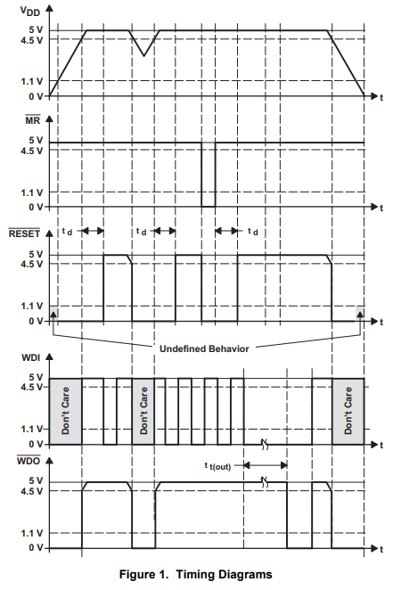

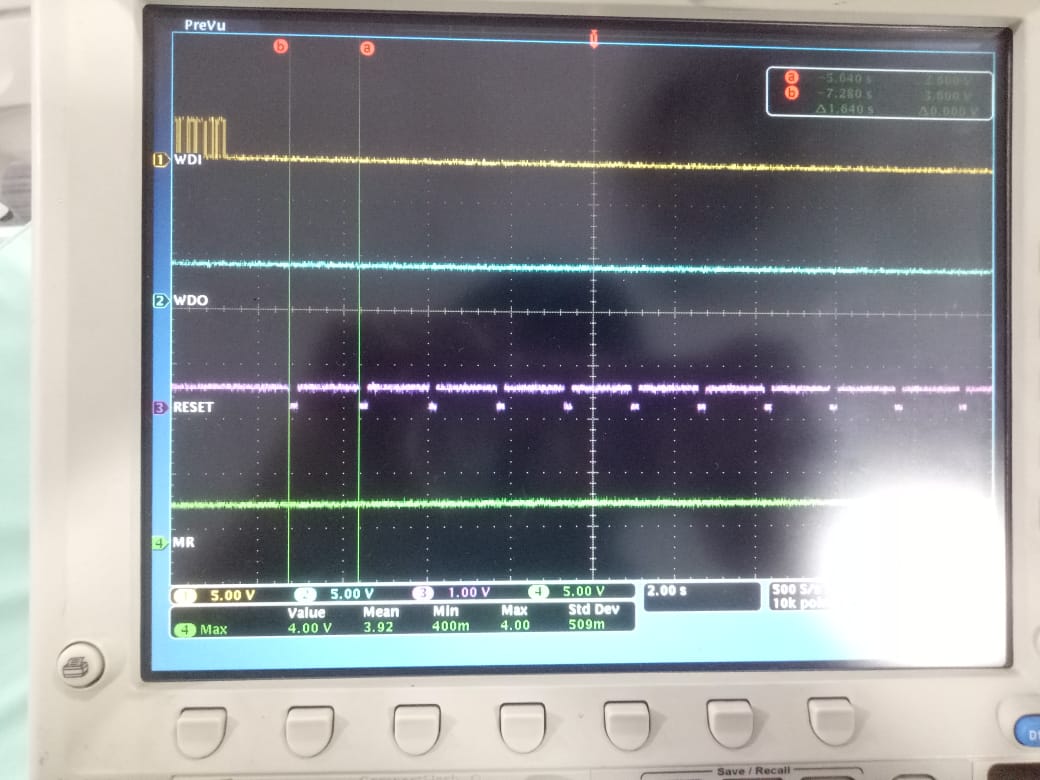

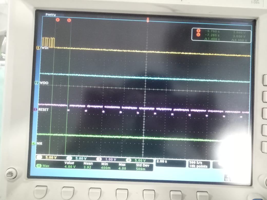

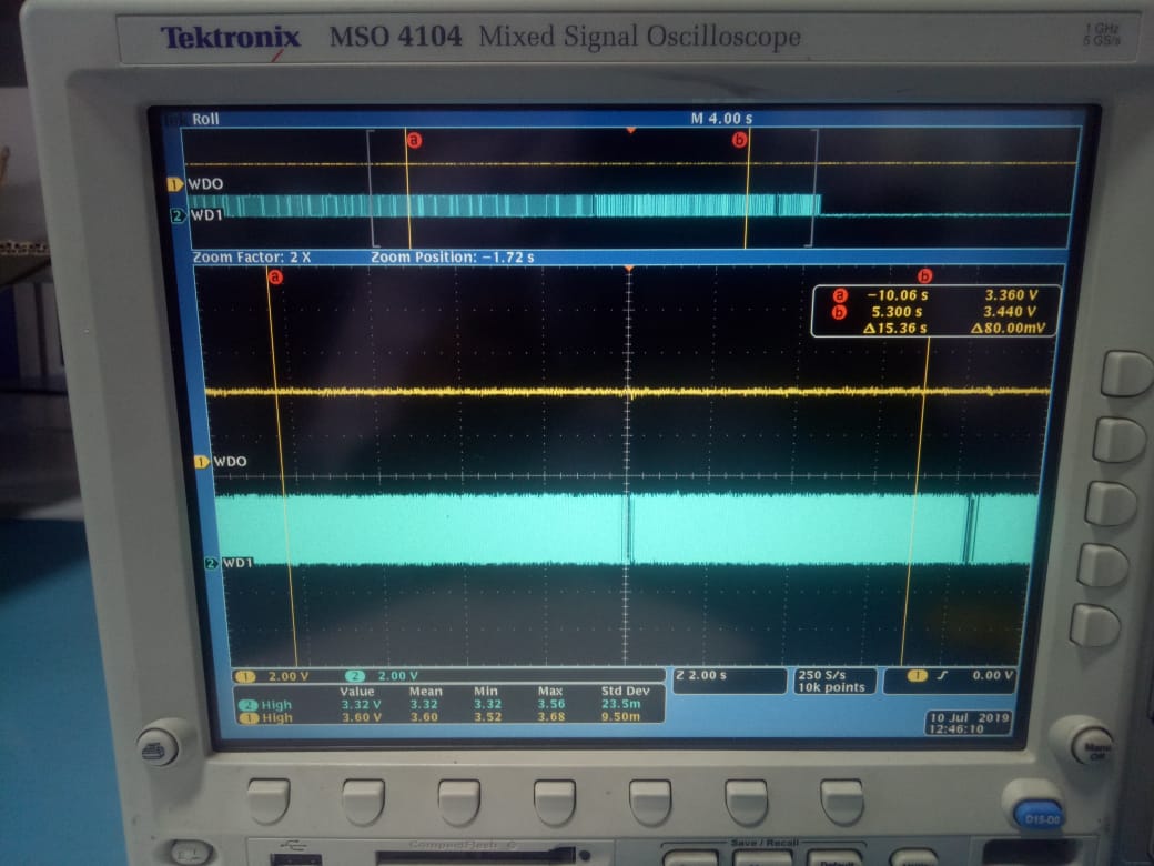

As per the datasheet, the WDO is supposed to go low if there is a watchdog time out of >1.6 s. But, I did try to pull the WDI signal to ground continously for 10 seconds or even more, but could not see any difference to WDO signal, which remained logic HIGH throughout the testing. I have tested it with multiple samples.
Is there something that I am misinterpreting from the datasheet. Is there a different way to test the Watchdog functionality?
Are there other signals which adds to the logic.
