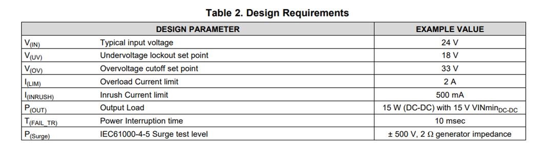

Hello team,
Please see table below from TPS2663x it shows that the test level is +/-500V 2Ω
My customer has to meets IEC61000-4-5 test level of +/-1KV 2Ω (which will give us 500A pulse),
their main output is 24V up to 4A, could you please advise if our device support that, if not could you please suggest other devices which support that?
Thanks in advance
