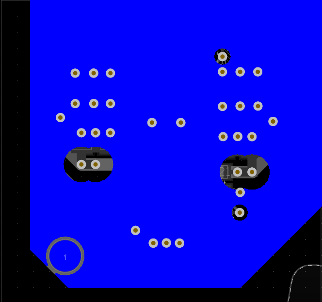

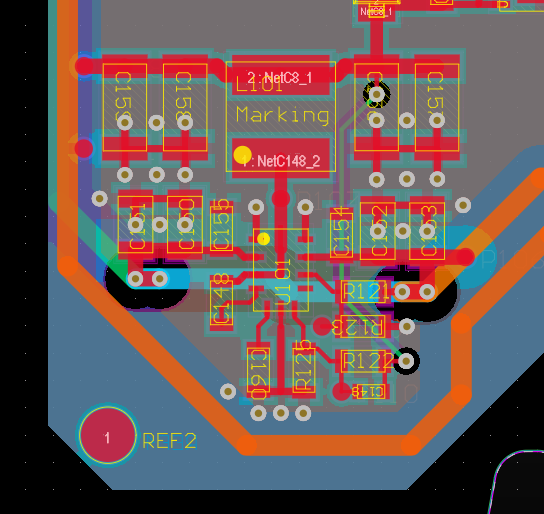

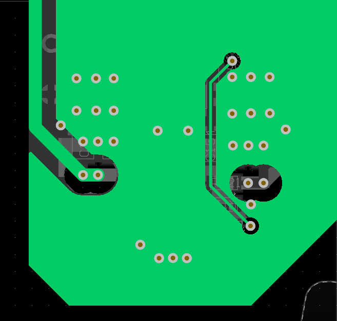

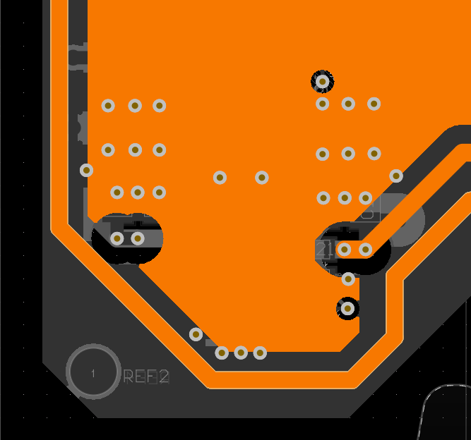

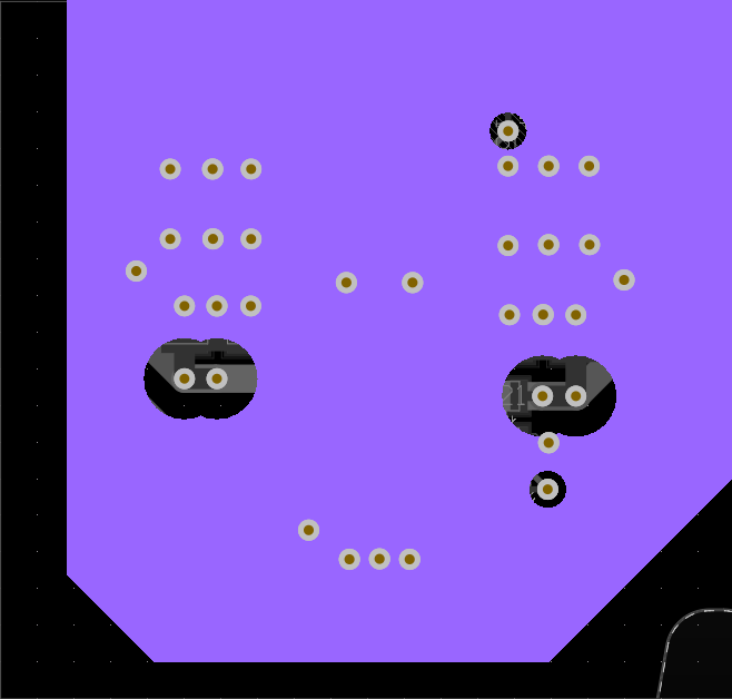

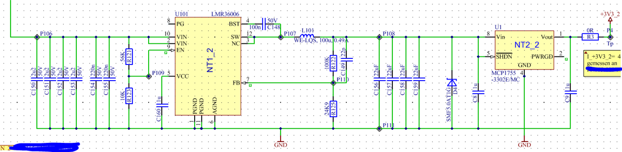

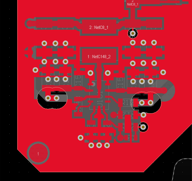

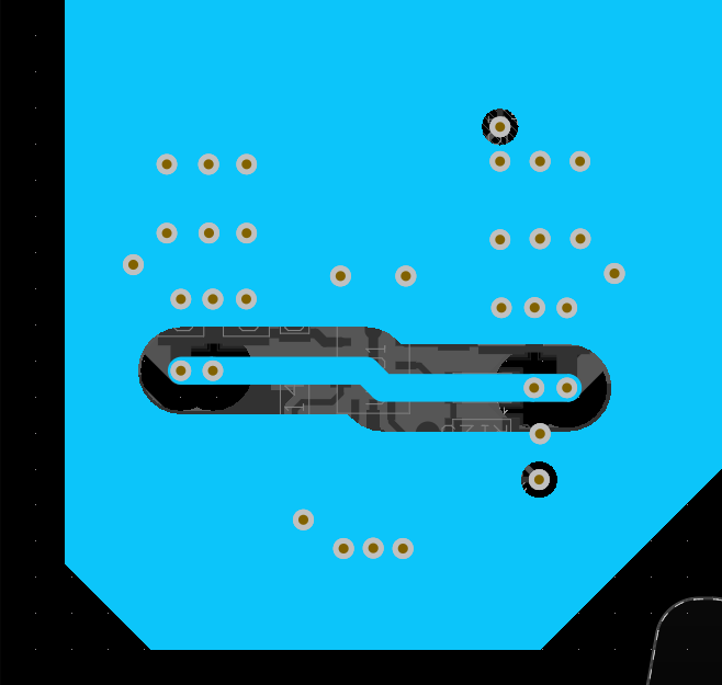

I'm getting started working with LMR36006BRNXT on a PCB prototype.
I'm hearing acoustic noise.
Here my specs:
Vin: 13-40V
Vout: 5V (LDO with SMF is needed)
Iout: 0.05A
I tried inductor: WE-LQS-4025 footprint with 47µ or 100µ.
Any advises for better Design?
