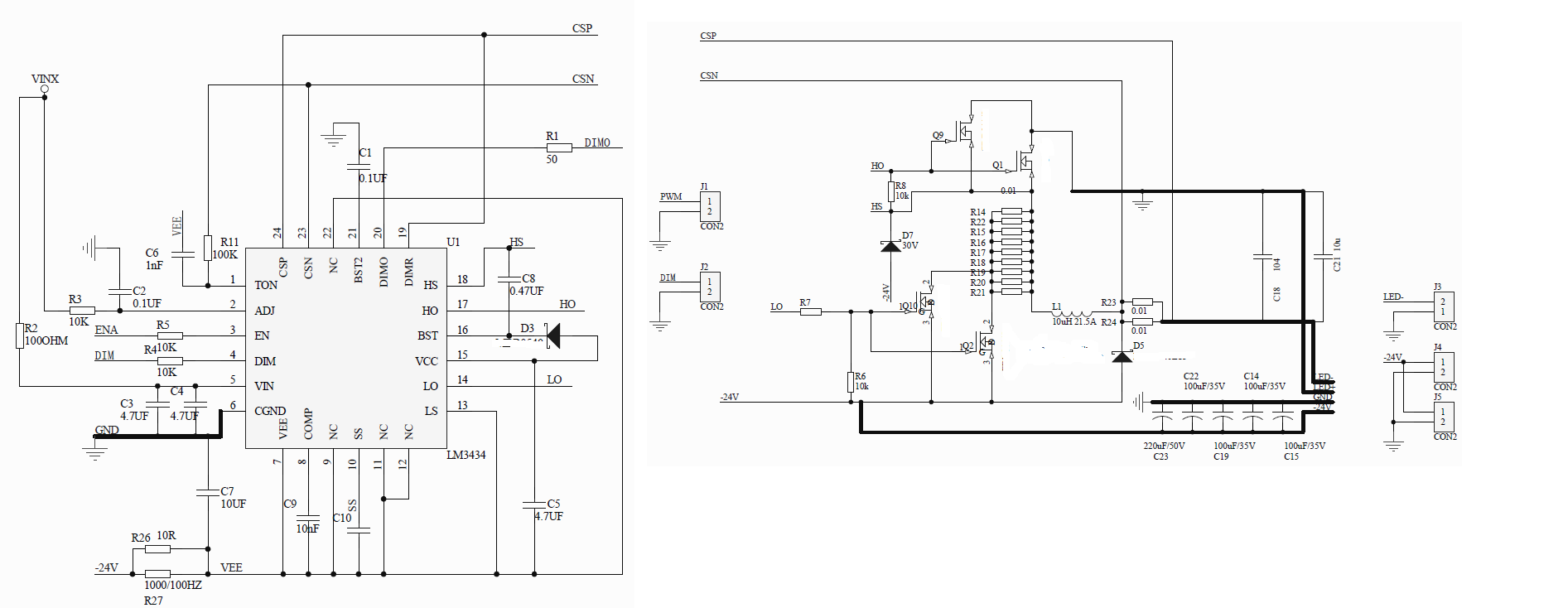

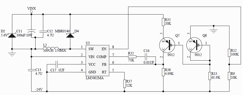

LM3434 for LED application
    our product used an old chip LM3434.
    Now have a problem.
    We have a frequency flicker mode of dimming.
    Frequency range from 0-20Hz.
    Now the problem is, as long as I send a frequency flicker signal.
   MOS Q2,Q10 was damaged, and IC LM3434 PIN14 also damaged.
What may be the cause?
Detailed parameters are as below:
Vin=12-15V, Vo=27V, Io=9A
thanks,
