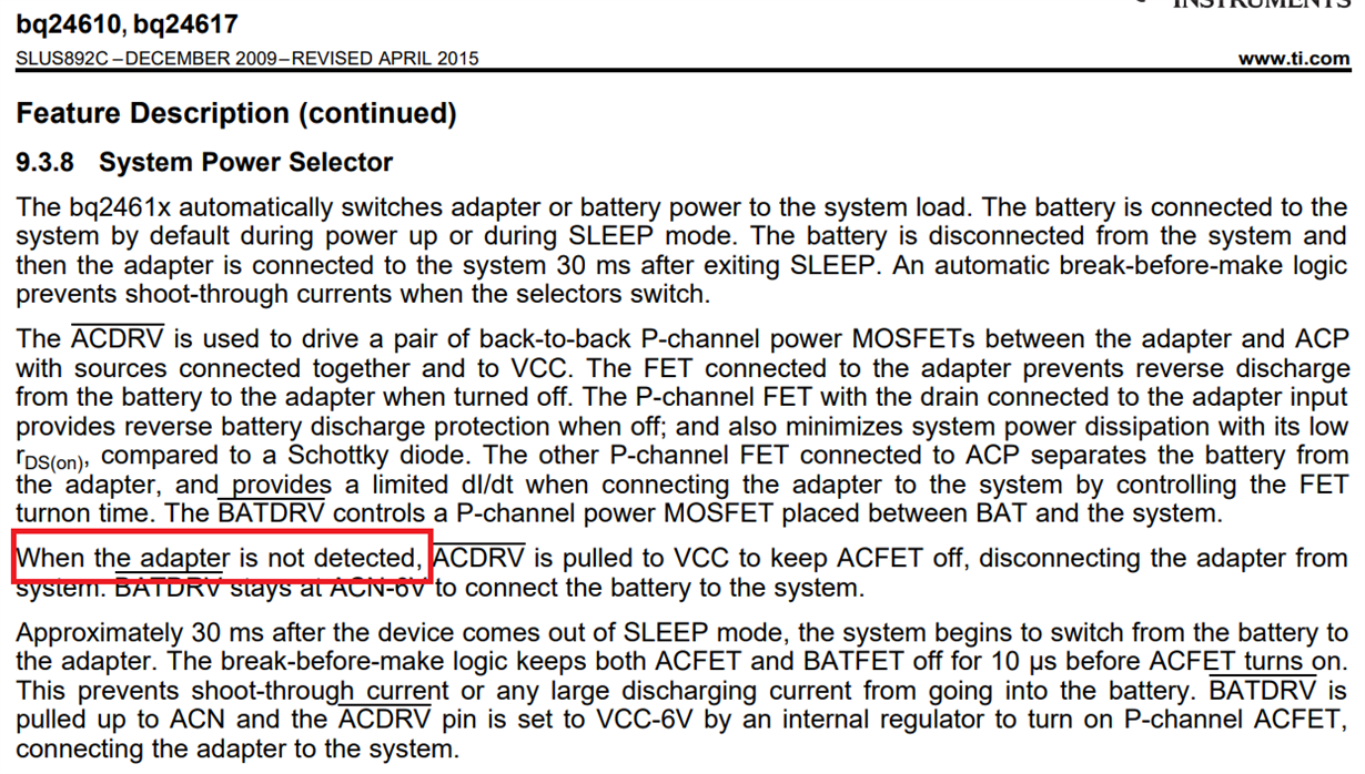

Could you please help to explain how BQ24610 do the adapter detection? Thanks.

Hi James,
Please refer to similar question answered on E2E forum below. Key point here is bq2461x automatically switches adapter or battery power to the system load. The battery is connected to the system by default during power up or during SLEEP mode. The battery is disconnected from the system and then the adapter is connected to the system 30 ms after exiting SLEEP.
