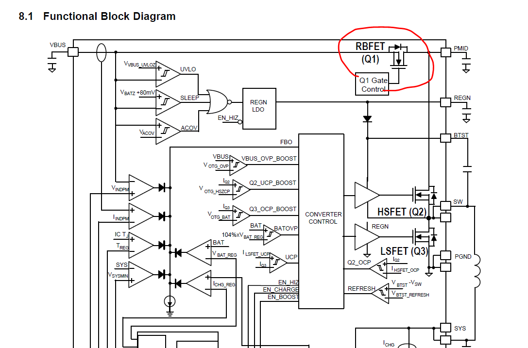

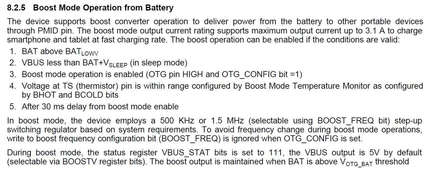

After meet the five criteria, boost mode can be enabled and PMID pin has boost vout, but VBUS no voltage.
Will RBFET(Q1) turn on in boost mode?
