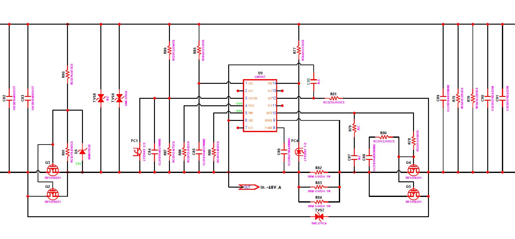

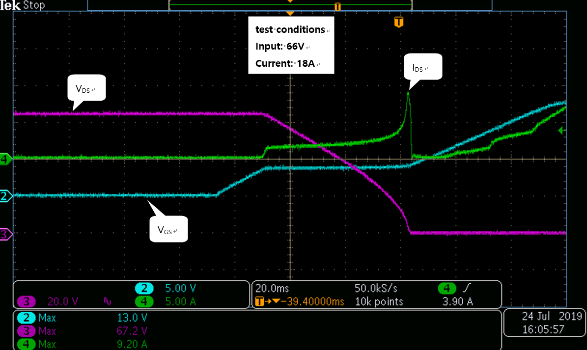

My Customer reqeust a design review and Check a waveform.
Condition ( Input Voltage : -66V, Max output Current : 18A)

Hi Louis,
Can you share filled up design calculator to review the design. It is available at http://www.ti.com/product/LM5067/toolssoftware
Rakesh

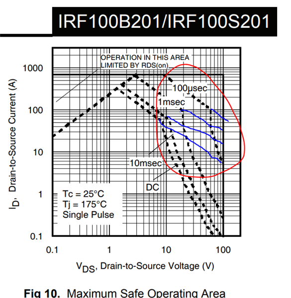

Hi Louis,
Thanks for the sheet. The FET SOA current data needs to be taken at max input voltage 72V.
The SOA of IRF100B201 FET is weak, please consider PSMN4R8-100BSE

Hi Louis,
Looks the design does not have enough SOA margin during startup. Is the FET failure repeatable ?
Rakesh

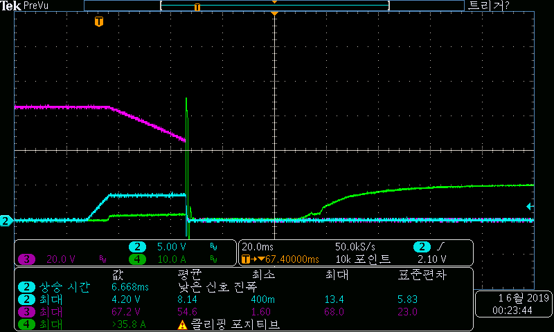

Hi Louis,
Not necessarily as there can be mismatch between FET to FET. Is there any difference in startup load conditions for the failed board and passed boards?
Are you able to fill the design calculator to check the SOA margin.?
Who is the customer? Did you have local TI field engineer support to have look?
Rakesh
Hi Rakesh
Thanks for your fast Feedback.
All Startup load Condition is same.
we changed the FET to FDP036N10A. and Tested it.
SOA of FDP036N10A is better then IRF100B201.
but failer rate is higher then IRF100B201.
Best Regards.

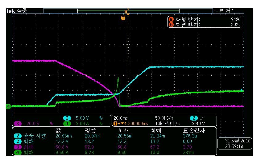

Hi Louis,
Can you increase GATE capacitance on misbehaved board and check the startup profile again.
Also, I am waiting for design calculator. Please send separate sheets for each FET.
Rakesh
Hi Louis,
Ok.
Use 0.22uF on the misbehaved board and test.
Rakesh
Hi Louis,
The inrush current profile looks good now. Please let me know if you have any other issues
Rakesh
For a given FET, we have two options to increase SOA during startup.
1. use lower power limit
2. operate in dvdt control mode by adding capacitance at the GATE. The higher gate capacitance helps reducing the inrush current.

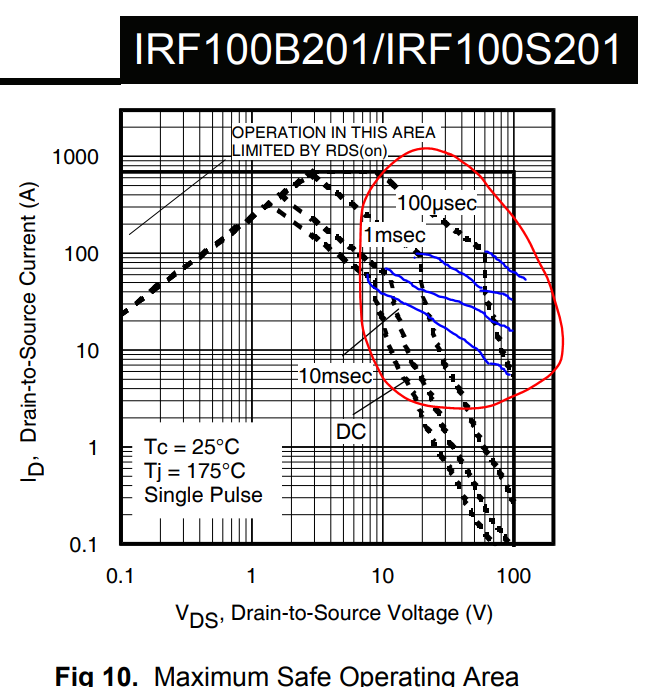

Thanks for the answer.
I do not know much.
I have additional questions.
1. Please explain about DVD control mode operation.
2. Is setting the inrush current low enough to get the SOA margin of the current applied IRF100B201?
Decreasing the resistance of the PWR pin lowers the inrush current.
Is it OK to lower the resistance of the PWR pin to get the current IRF100B201 SOA margin?
3. Tested now is the worst condition.
However, the actual field supply voltage is 48V to 54V.
Is there any other problem when the maximum voltage of the field is supplied to 54V?
It is 12V lower than the voltage tested.
54V => IRF100B201 Is there any SOA margin?

1A) The application report http://www.ti.com/lit/an/slva673a/slva673a.pdf covers the design aspects of hot-swap system. The power limit and dvdt control are covered. Please go through it
2A) 3A) we suggest to use stronger FET having single slope power limit lines. The FET like IRF100B201 has double slope and are prone to thermal instability during startup, current limit mode of operation. The recommended FET is PSMN4R8-100BSE

Hi Kim,
FET to FET variation in process/parameter, operating temperature and loading differences may be the reason to see failures on some of the boards. I suggest to take few boards and do all the critical tests at max. Vin (54V), max. operating temperature.
Critical tests are
Rakesh
