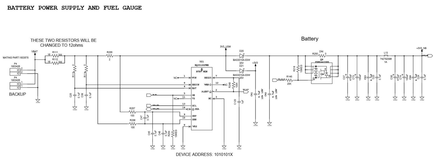

My customer would like to use BQ35100 device for ultrasonic flowmeter application. Could you please help to review the schematic diagram as below? Thanks a lot!

hi Zhengquan
-R111 and r112 serve what purpose? I don't believe they ought to be present.
-R113 should be 100 ohm.
-Why do you have your sense resistor high side? It ought to be low side as per reference schematic.
is this a 1s application?
