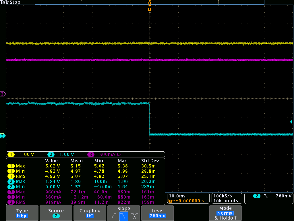

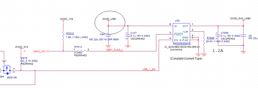

Customer is using this one for current limit.
Can you check the reason why it is not precise enough?
We design the current limit: Imin~Imax 939mA~1.1A
But when we set the loading at 890mA the flag will go low, but the 5V still working.
1.already check the resistor have 1% accuracy
2.Two boards have the same issue
BR
