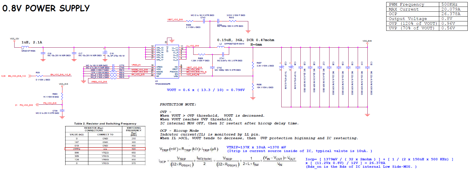

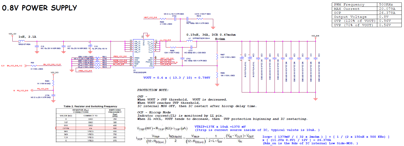

Dear Team,
Here is the TPS53355 schematic.
Can you help on final review?

Kevin,
We will get someone to review it.
Hi John and Kevin,
I will review this schematic today or tomorrow, and provide feedback no later than tomorrow afternoon.
Hi Kevin,
First off, this schematic is an excellent example of a well marked up, and fully informative schematic. This shows what specs the end user desires, and makes for a very straightforward review from our end. Thanks to you and to the end user for providing all of the info.
I have a few changes that I recommend:
1) The ripple injection circuit can be adjusted to provide a slightly higher injected voltage (This is a best guess due to the mixed caps on the output)
A) Change R808 to 1.33kOhm
b) Change C741 to 0.047uF
2) Adjust the Vreg pin connections
A) Add a 1uF bypass capacitor to GND
B) Change the R811 connection. It should connect VREG to PGOOD (not GND)

Hi Kevin,
Sorry I did not realize PGOOD pulled up with something else. That should cover everything I mentioned then. It looks good to go.
Be sure to have the engineer follow as closely as possible the layout recommended in the datasheet for the bypass caps and the FB resistors.
