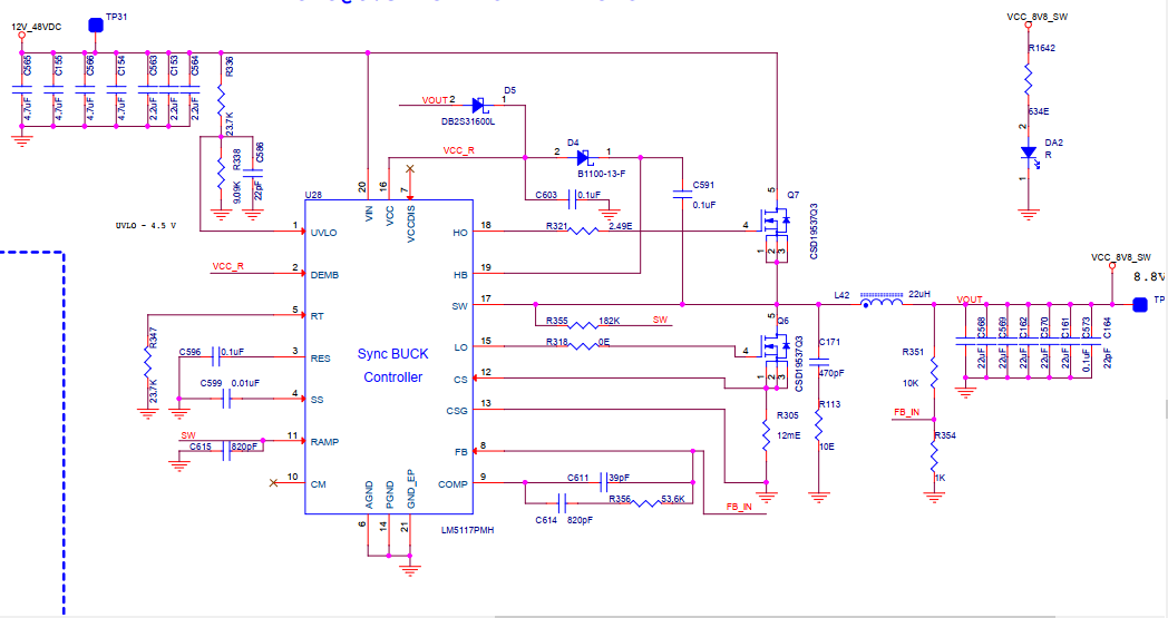

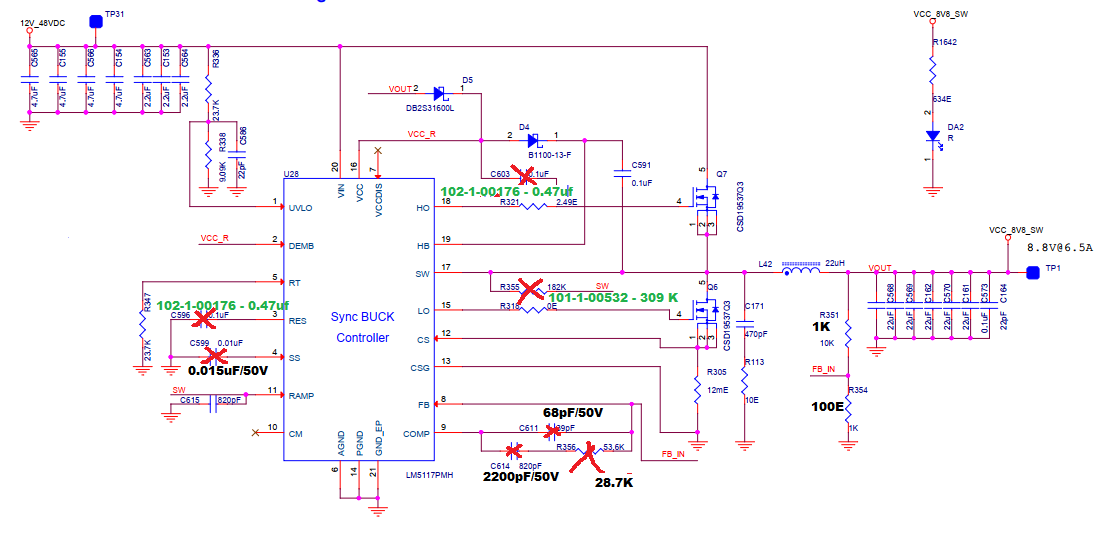

LM5117: Messed Switching Frequency with ringing cap sound
Part Number: LM5117
Hello TI Team
I am getting random issue in the LM5117 Buck Regulator. In random Issue following are the Observations
1) Output Voltage decreased to 8.3 V from 8.8 V , with increased ripple
2) Improper Switching Frequency . Waveform attached
3) Ringing capacitor noise coming
4) Inductor gets overheating.
