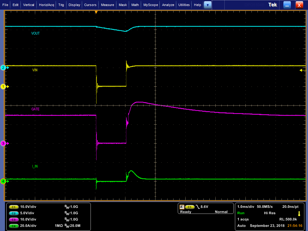

    Regarding the concern raised by your peer, there is no issue in LM74700-Q1 turn on with its OUTPUT (Cathode) powered already.
    Refer to the attached picture (VIN is Anode, VOUT is cathode).
    Kari.
  • Thanks Kari.....
    So at 20A / Div I will have to take your word on leakage current  when Vin (Anode) is off and Cathode is hot as it is hard to tell from C4. A few questions:

  • Hi Steve,
    Above waveform is it indicate that the part does not have any issue in turning on when cathode is powered or has some voltage potential. (You had a question based on peer experience). This is not an indication of leakage.
