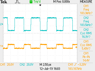

I hawe problem with sm72295 buck converter  actually i use Typical Application Circuit
and also try wiht tida0120 PMP7605
it is working most of the time normally  but time totime converter dors not start up
 also try wiht tida0120 PMP7605 and tida120 software  i have same result
additional info if converter  not start up i see input side signal with osciloscope
and Hsa and Hsb volate is missing
and after severel  restart it will be start up suddenly
can you advice

  • Hi A. Cem Cezali,
    thanks for reaching out about SM72295 and welcome to e2e!
    have you changed any component on your schematic or is the circuit taken exactly from TIDA-00120 (
    When you refer to HSA and HSB are you referring to the pin of SM72295? or the switch node of legA or legB? are both legs of the full bridge acting the same?
    if both HSA and HSB are not there then there may be an issue with the high-side supply preventing the high-side FET from turning on the bus voltage to the switch node (HS). are you seeing LOA and LOB output signals from SM72295? the low-side needs to turn on to replenish the bootstrap every switching cycle.
    what is your switching frequency and VCC voltage?
    what is your VCC capacitor value? what is your HB-HS bootstrap capacitor value?
    what FET are you using and do you know if they are damaged? are all the FETs in the full bridge the same? A significantly larger FET than that used in the TIDA can lead to the bootstrap cap not replenishing itself fully and eventually lead to UVLO in which the driver shuts off the output.
    can you show me your schematic if anything has changed? Also during start up or working operation can I see a cycle or two of LOA,HOA, HSA and HBA (with respect to GND) waveforms for legA?

    VCC is 10V frequency ~ 200Khz
    capcitor value 0.47uf
    all fets is ok because its working most of the time
    All components exactly same except  mosfets i used csd19532 instead  of csd18532
    gate charge  csd19532 is 48nc  csd18532 is 44nc its not big difference
    only one thig  tida-0120 working more stable working  than my prototypes

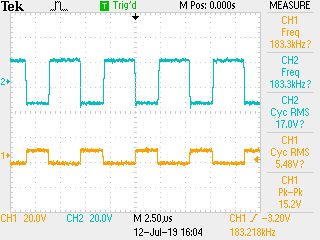

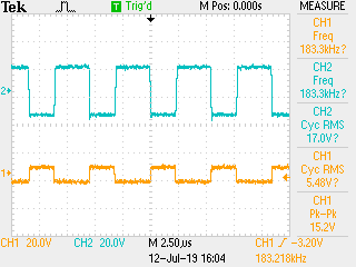

    my prototype is using csd19535 TO3 case HB HS capcitor value 0.68uf its
    blue HOA orange LOA
    blue HOB orange LOB

  • Hi Cem,
    thanks for the update, take your time getting the board up again.
    from the waveform you sent the signal at first appears to look ok (with some dead-time). However when I see the reference of the waveforms I can see that they go negative and almost as much as it goes positive. Your Oscope might be in AC mode? or if not, this tells me there is either something wrong with sm72295 PGND connection on the PCB or with your test measurement setup. Did you change the PGND on your prototype setup? can you tell me exactly where you are probing the reference of LOA/HOA (it should be pin 23 of SM72295 or something connected close)? are you connecting AGND (for the 5V VCC) and PGND at one point near the device?
    thanks,
  • Hi Jeff
    Yes my scope is ac mode
    my reference conected to exatly Pgnd just few cm distance from SM72295 pin 23
