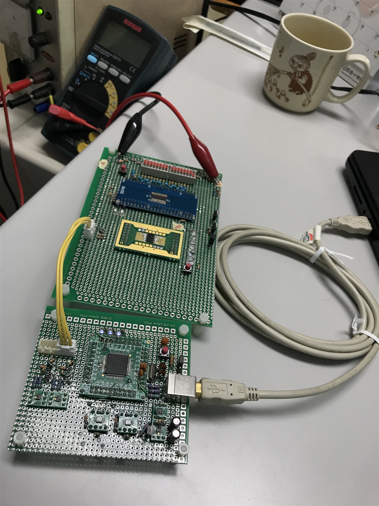

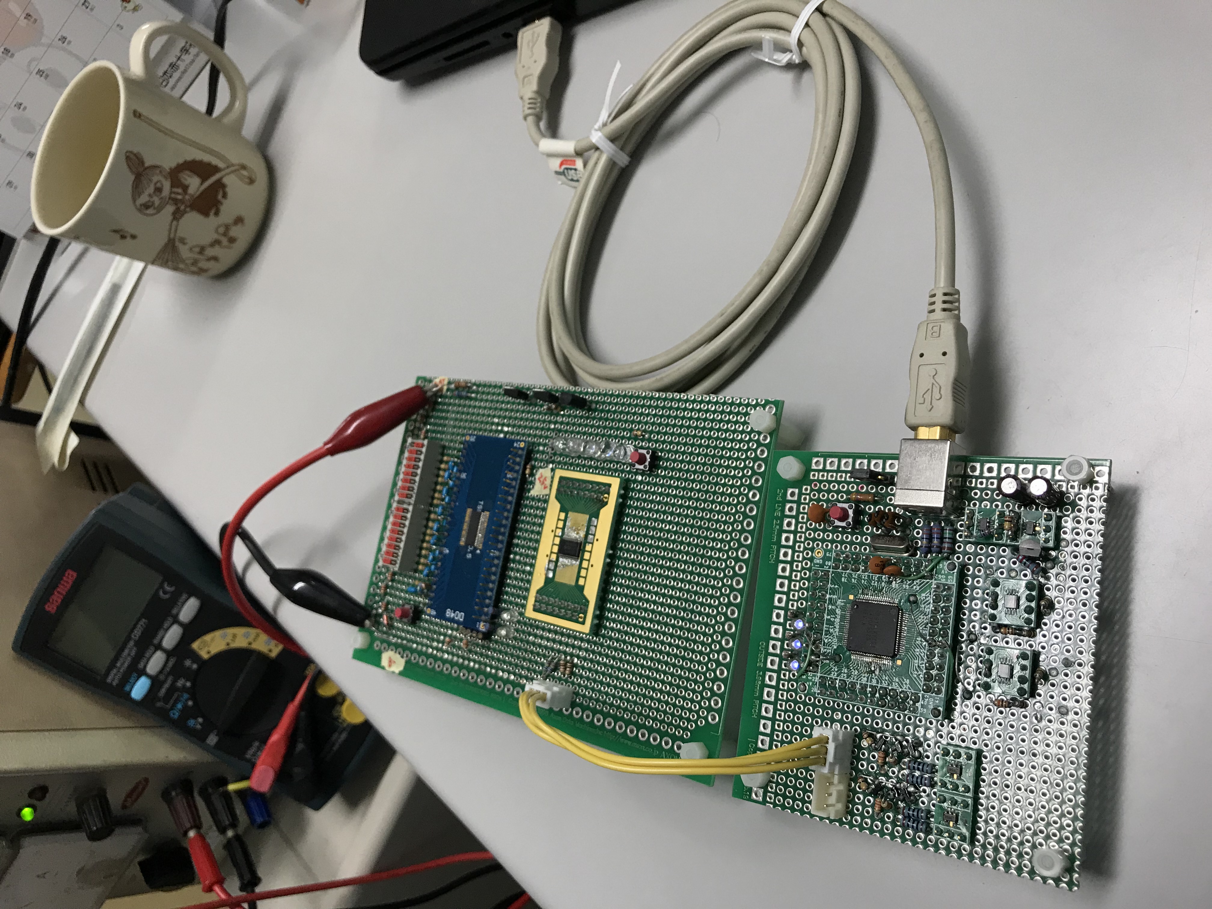

I made a board of EV2400 and a part of BQ76940EVM by refering the schematic in the user guide of them.
However I could not communicate with BQ78350-R1 from bqstudio.
I could communicate with EV2400 board and could see the version of it (0.28). All leds lit.
And I measured the voltage of some point as follows. They looks fine, I guess.
[EV2400]
VCCs of MCP430 : 3.3V
High side of Pullup R (SMBC/D output) : 2.4V
[BQ76940EVM]
REGOUT of BQ76940(=VCC of BQ78350-R1) : 2.5V after BOOT
BAT of BQ76940 : 45V (applied)
Would you advice anything ?

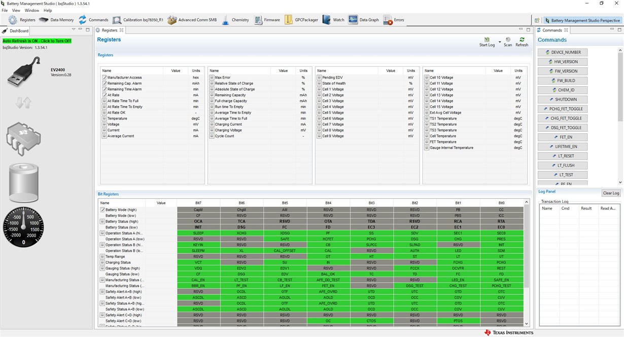

  • Thank you for your quick reply.
    In fact, I solved the issue myself last night.
    At first, I checked the SMB signals on the J2(SMB output of EV2400), and there were no signals.
    Then I checked SMB lines from there to MCP430, those signals are stopped at the level shifter IC (TXS0102).
    I made a wrong power connections of it. Those were VCCA>VCCB.
    I fixed them and then SMB signals reached to bq78350 finally.
    Now I can see the bq78350-R1 from my PC.

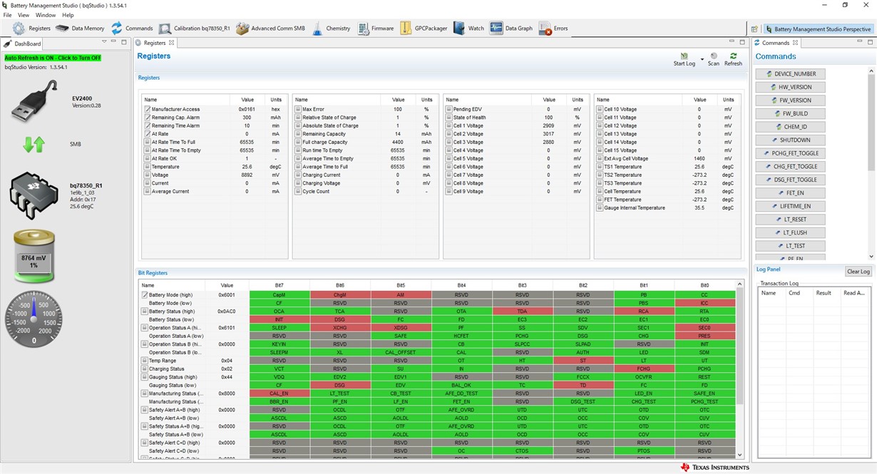

    There are some strange values in cell voltage (bq76940 is monitoring 15 series resisters but there are only 3 values),
    but I check my circuit again.If I can not solve this new issue, I might post another thread.
    Anyway, thank you again for your reply.
    Makoto Teramoto
  • Hi Makoto,
    Glad to hear you found the issue.  The cell voltage reporting is fixed by setting the AFE cell map, see details in the BQ78350-R1 version Technical Reference.
  • Thank you for your advice about the cell voltage.
    I also fixed them by bqstudio. I can see all 15 values now.
    From now, I will explore and enjoy the bqstudio and AFE.
