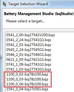

BQ78Z100: Why the newest battery manage studio do not support 1100_05 firmware?
Part Number: BQ78Z100
The newest firmware is 1100_0_05,
How can I get the 0.06 firmware or battery manage studio to support  0.05 firmware?
  • Hi Zhao,
    Please download the firmware from the bq78z100 page and then copy the bqz file in the package to c:\ti\batterymanagementstudio\config directory. I think it's an update that was accidentally excluded from the bqstudio installer.
