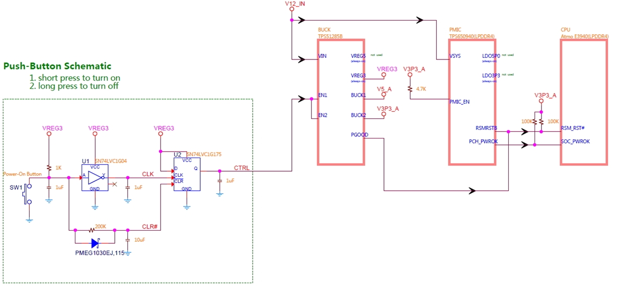

Dear Sir,
    We are now using TPS650940 as PMIC and TPS51285B as BUCK for Intel APL-I and without EC.
    The BUCK have 2 always-on rails, VREG3 and VREG5 and we use VREG3 only.
    The PMIC  have 2 always-on rails, LDO5P0 and LDO3P3, not used.
    The Power of Push-Button circuit is VREG3 and the output of Push-Button circuit is 'CTRL'.
    Should we connect 'CTRL' to enable pin of BUCK or enable pin of PMIC?
    The attach file is our block circuit.Thanks!
3125.SCHEMATIC1 _ PAGE1.pdf
    I reviewed the block diagram and the concept match closely to the Push-button application note:
    One note that I have is that the SN74LVC1G04 likely needs to change to SN74LVC1G14 which is Schmitt triggered and was updated in the original app note.
    I do not see any issue with connecting CTRL to TPS51285B enable. As long as the TPS51285B is powered up before our PMIC_EN goes high, that should allow PMIC to have proper start-up. One test that will be necessary is confirming that the 5V is available when PMIC_EN goes high. It may be desirable to have an RC+diode on the PMIC_EN pin from V3P3_A with the diode connected to CTRL. The RC would delay the PMIC_EN to ensure that the V3P3_A and V5_A are powered up before TPS65094 starts powering up. The diode would ensure PMIC_EN goes low as soon as the CTRL pin goes low.
    One last point is that you may prefer the TPS650945 instead of TPS650940; it has BUCK3/4/5 in force PWM which improves their performance and stability.
