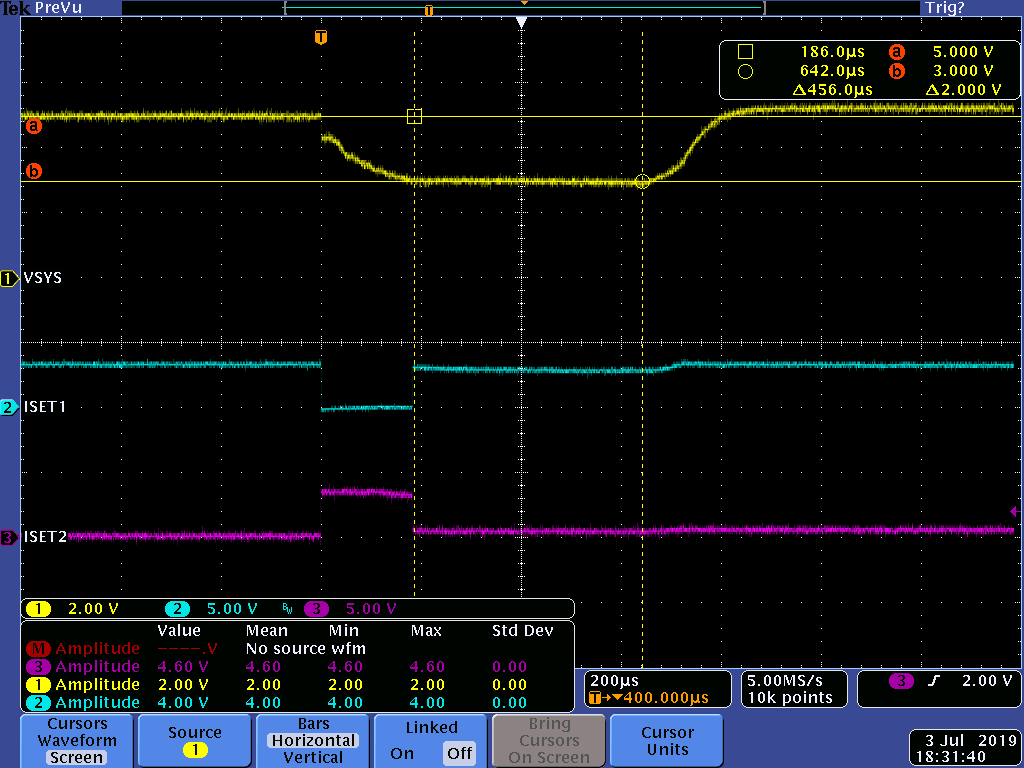

BQ24075T: bq2407xT Input current transitions
Part Number: BQ24075T
When trying to transition from input current of 500mA to 1500mA (transition form 10 to 01 is simultaneous) , the input current changes trough either 100mA or 0mA.
This causes problem when the battery is absent. This causes the system to reset.
Is there a work around?
