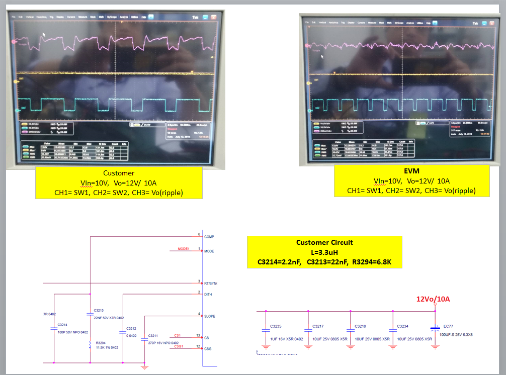

Please refer below picture, customer's output ripple different with EVM.
Please you kindly provide improve suggestion.
Electric spec: Vin=10V~36V, Vo=12V/10A
Thanks!

Hi Steven,
Thank you for posting. Obviously your output filter is not effective. It implies the layout problem. You need to modify your layout such that the switched current will be forced to pass through your output capacitors as you expect before it gets out to the load. Please refer to our EVM layout as the example.
By the way, the shown Vout ripples have nothing to do with COMP pin network.
