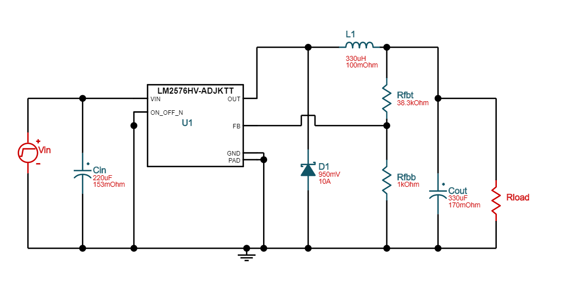

DEAR TI TEAM ,
I NEED YOUR HELP REGARDING THIS MATTER . I WANT TO MAKE A SUPPLY FOR CONSTANT CURRENT SOURCE 2A BY USING LM2576HV-ADJ(ADJUSTABLE VOLTAGE REGULATOR).
WHERE
VIN=48V
VOUT=48V
IMAX=2A
  • Hi Peeyush,
    Can you explain what you need help with? Unfortunately, if your output voltage is 48V, the input voltage would need to be greater than 48V for the design to work. Webench is currently recommending input voltage between 50V and 60V. Here is the design it produced:
