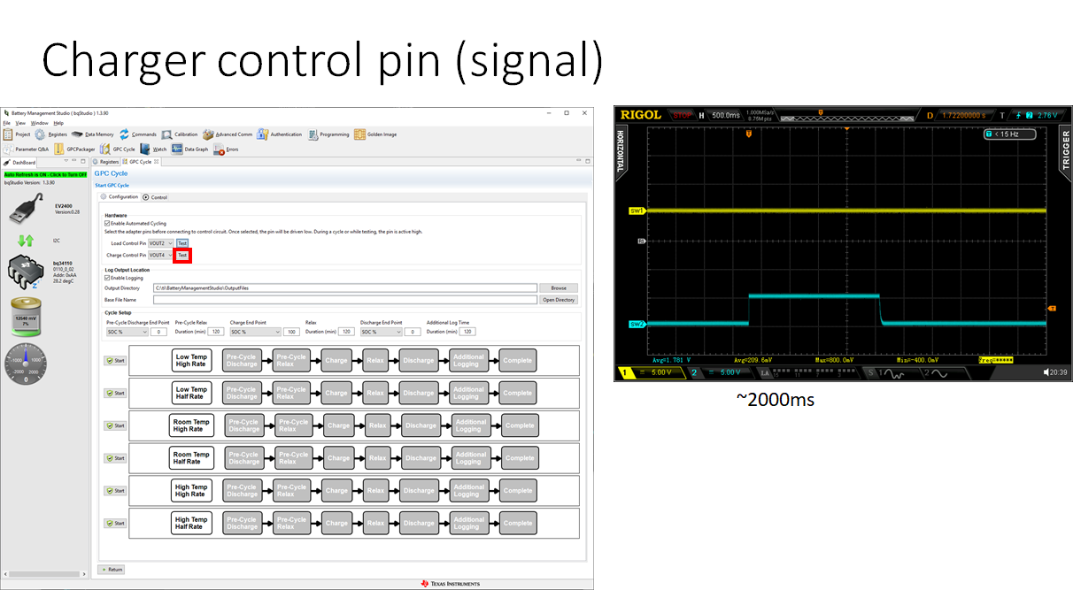

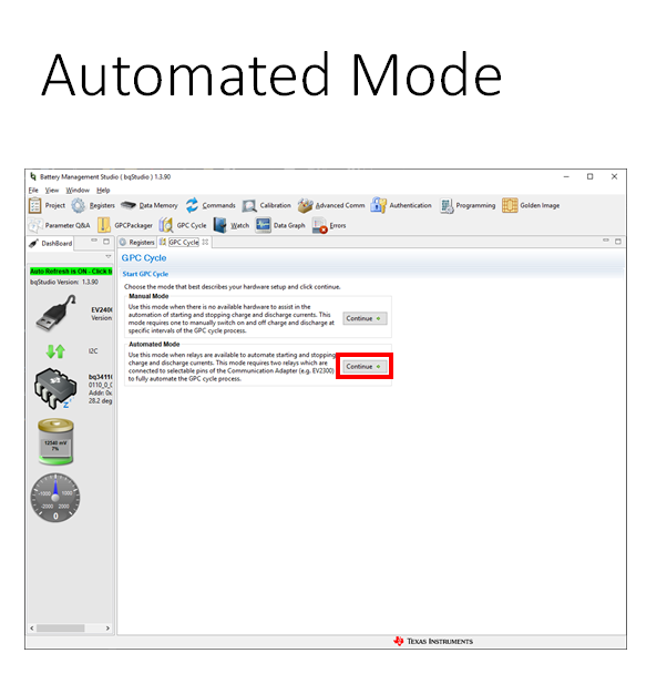

The bqstudio ver 1.3.90 Build1 (from April 16, 2019) has the option to automated the GPC Cycle.

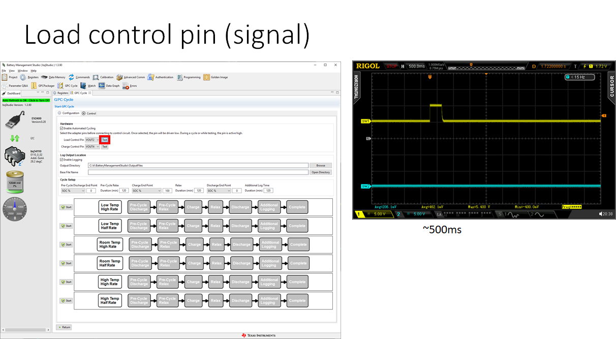

Once Automated Mode is selected, the UI allows to test the pins VOUTx of the EV2400. There are two push buttons with two states: pressed and released.

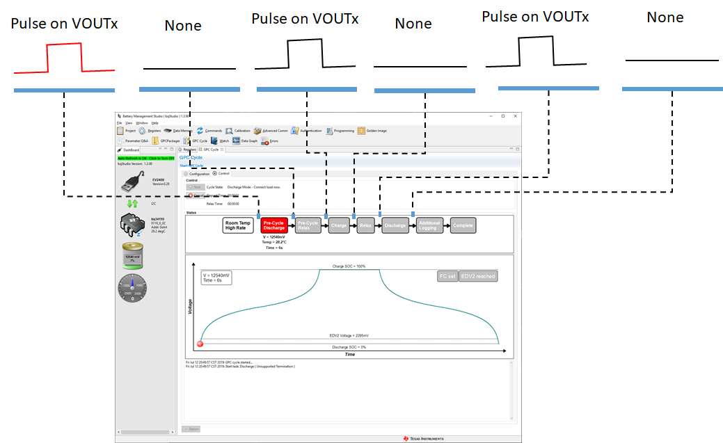

My expectation is that while the button state is pressed, the VOUTx signal keep high until the state button is change to release. However, the signal pins are high for some variable time (around 500ms and 2000ms) independently of the button state.
I started developing a system to detect these pulses (based on a micro-controller) in order to control two relays to enable/disable the charger and load. However, after each stage is finished, there is not signals on the pins
In summary, may the GPC cycle can be performed in automated mode using the EV2400?
